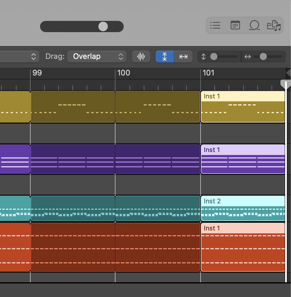

Lately I keep getting the maddening behavior that I cannot cursor to the right, scroll right or shrink the timeline down so I have space on the right.
The composition just takes up the whole space and Logic is adamant that there is nothing to the right that I need to be made aware of or use.
There isn't anything to the right...yet. But like a lot of people working in DAWs. I like to cut and paste stuff, so I'll chop out a section of the song, scroll to the right and paste it. Then edit it to be a little different, or just grab all of it, zoom in, and slide it into time with the existing tracks.
So it is pretty nuts when Logic just stops me from going to the right!
Before anyone says it, yes I have the |<->| deselected.
I should be able to zoom out so that the whole song is bunched up on the left hand side!

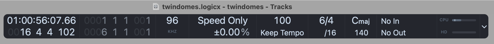

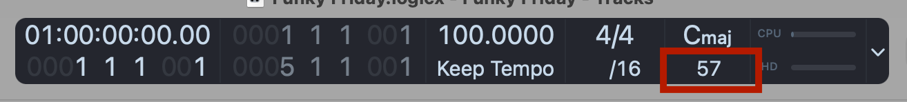

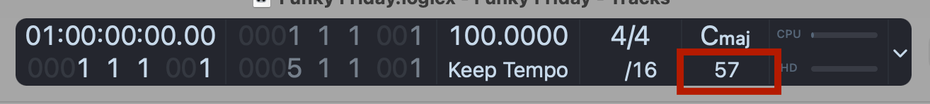

I haven't found a way to turn it off. The default is 129. I adjust my project end using the LCD, which you can drag up and down. This is my custom LCD setup I use for most projects. If I'm going to be noodling, I set it at the start to about 250 and adjust down later if needed.

Here's a little more about this from the guide:

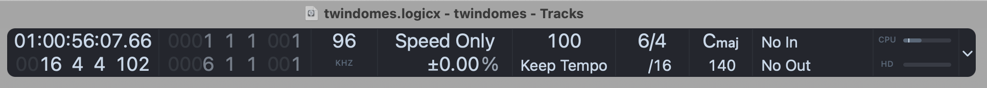

Now that IS odd, it looks like my default, at least for the current project is not 129. But 102?
Also, this is what my LCD looks like now.

No, it's 140 under the Cmaj key on the right. When you customized the LCD, the key and project end are one item. The 102 is the playhead position (bars). You can tell what's what by hovering your mouse over the item.
And apparently the default project end is based on the time signature. Your LCD shows 6/4 and /16 below it. If you change it, the default project end automatically changes. I hadn't really noticed that before now.
yeah, thats after I fixed it. In the first photo you can see my project faceplanting on 102.
