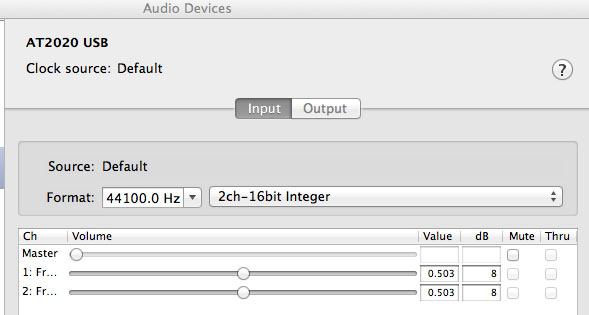

IF you are using a USB mic, try this. Open the Audio MIDI Setup program - it should be in the Utilities folder inside the Applications folder. Use the Window > Show Audio Window menu if you don't already see it. There should be an icon in the left pane that represents your USB mic - click on it.
Now you should see a volume slider on the right (or two sliders if it's a stereo mic). You can raise the level here. I have an AT2020 USB mic and the default volume level was very low (about 40% IIRC).
Raise it up as high as you like here. You can even do this while Logic is running and you will hear the difference as you move the slider. This is what it looks like with my AT2020

the Audio MIDI Setup program in the utilities folder is just the same as using the slider in system preferences/sound, moving either also moves the other.
i have it set on 85% so i can hear my acoustic guitar but there is too much hiss, if i turn it down to remove the hiss (@50%) i can no longer hear the guitar, even having a big 12 string dreadnoughts sound hole 1cm from the mic!!!
