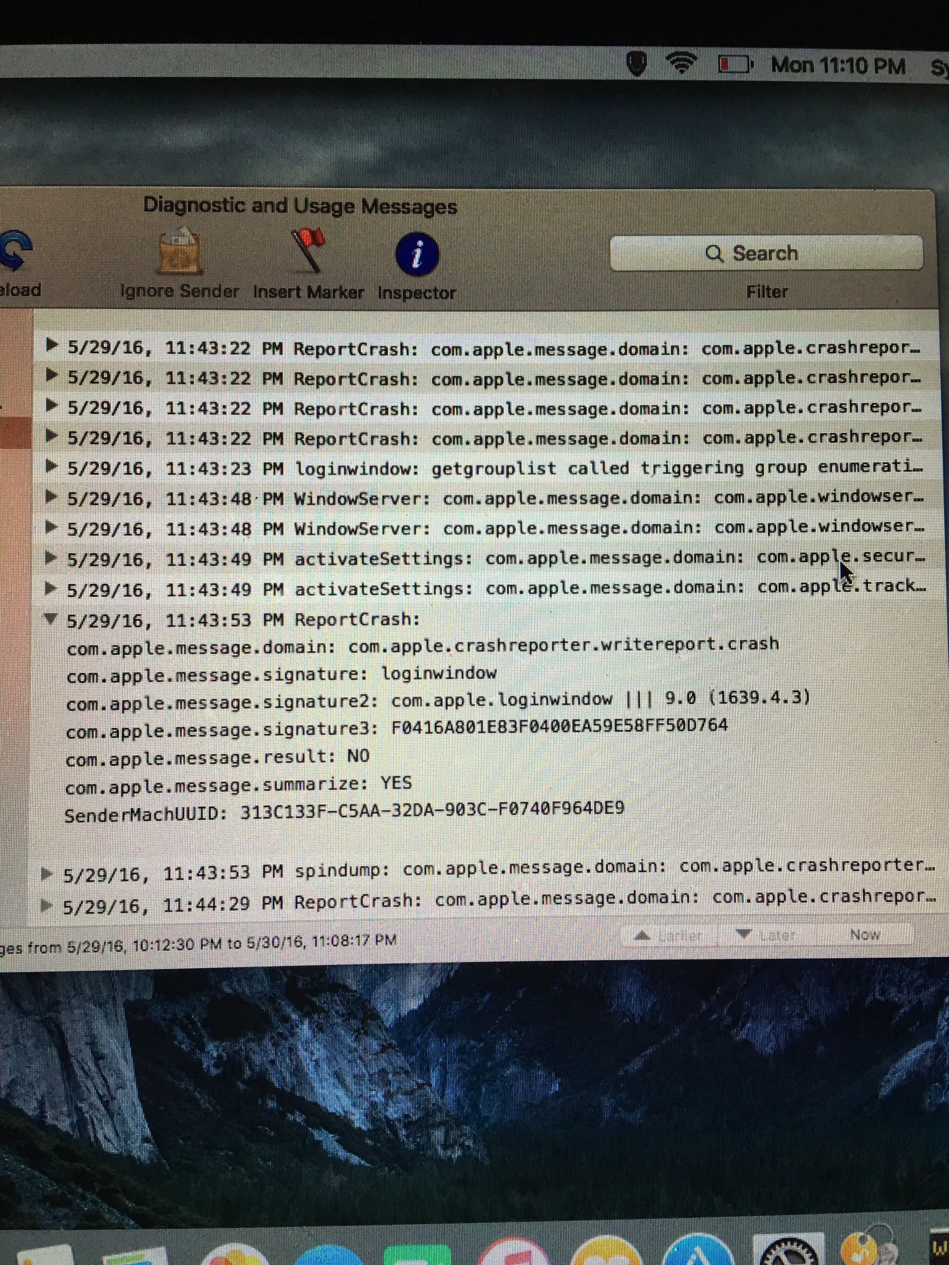

Whenever I access Console and go under "Diagnostics and Usage Messages" I see that there are a bunch of these "ReportCrash" messages and the signature is for the "login window". I assume this has to do with what I'm experiencing?

Firstly, please don't post screen captures of log messages because it makes helping you far more difficult. You can select log messages in Console by dragging the mouse pointer, and copy them to the clipboard by pressing command-C.

I also apologize about the screenshot. I wasn't posting it for others to use to help me, more of just a reference for what the problem I'm experiencing says.
