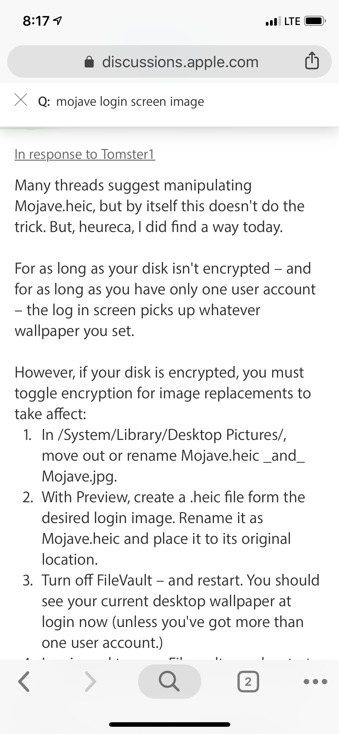

Previously, the login screen would copy exactly what you had for the desktop image. This is echoed on an official apple support forum. I screenshoted said article. So confused!

As I said, the OS doesn't even boot until you put in your password. Everything prior to that is done in firmware. The post you found details how to replace the images that the firmware uses.
