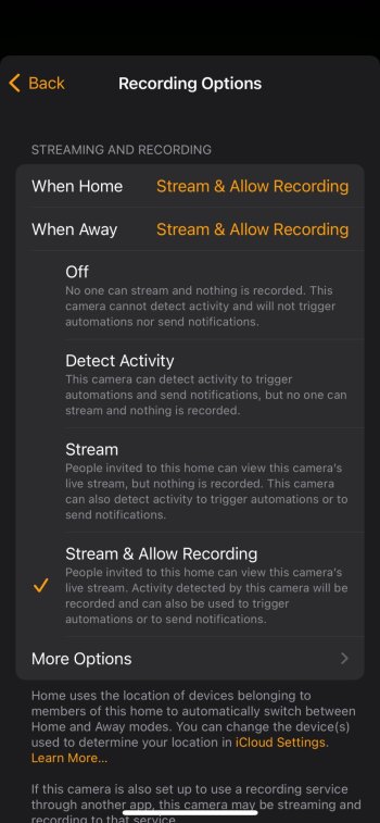

Purchased a Logitech Circle View from an Apple store last week, no issues with HomeKit setup, live view streaming is working fine. The issue I'm having is that I just can't see any recordings, not sure if that is me not using the Home app properly, or the device has some kind of issue recording videos via HomeKit Secure Video.

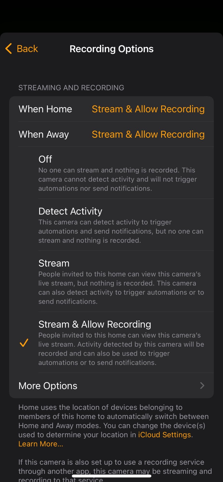

5 - Confirmed the Circle View settings in home, specifically Recording Options to ensure that When Home and When Away are set to "Stream & Allow Recording".

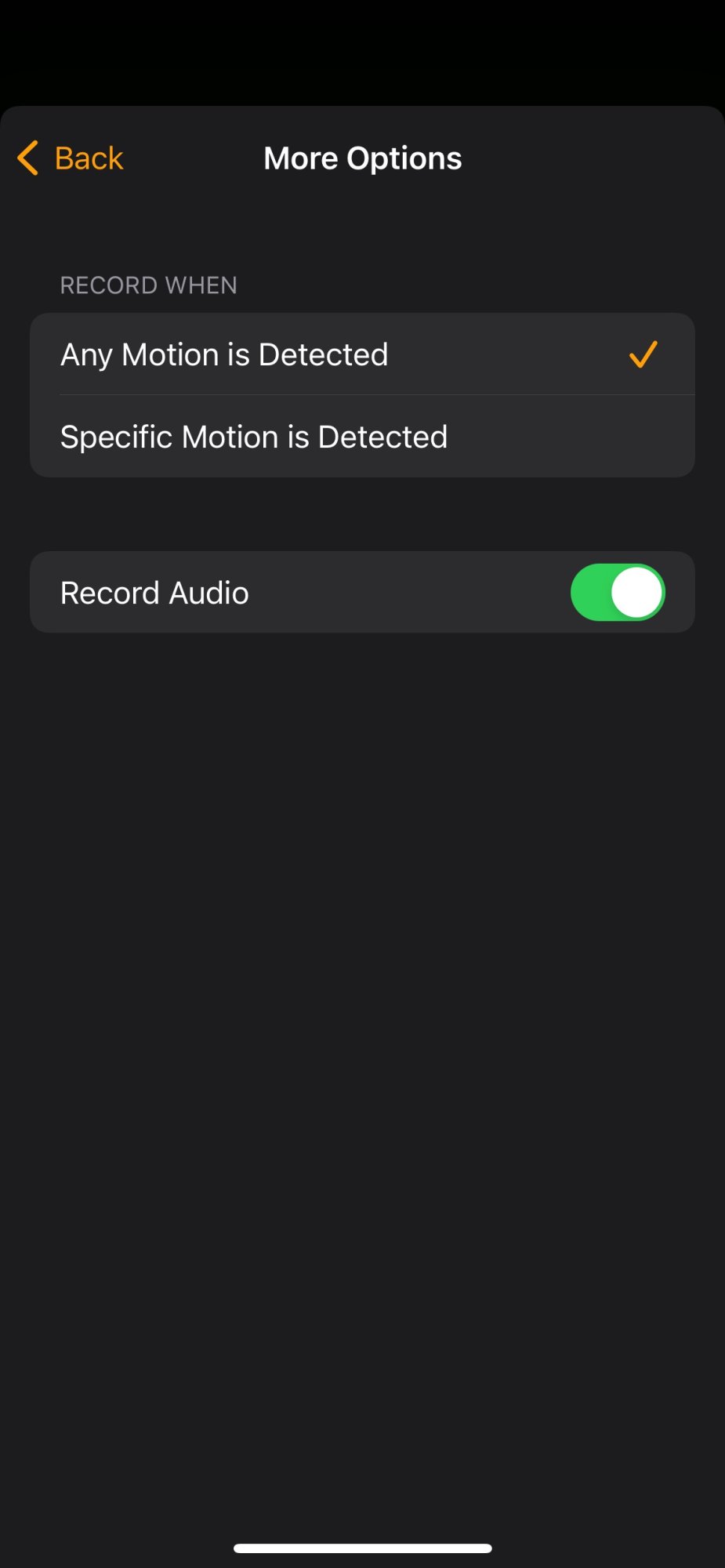

That is also a fair question, the config I have is basically set to record any motion no matter if I'm home or not. So I don't think this is a config nor "did anything move" question.

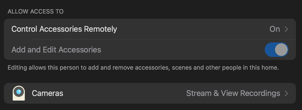

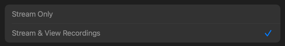

Update - Fixed.
** Fixed by updating permissions for my "Resident (Admin)" home account when logged into "Resident (Owner)" to "Stream & View Recordings". Not sure why one of the accounts was only set to only "Stream Only".
Reactions: StumpyBloke
Update - Fixed.

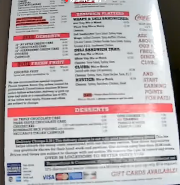

Well here is the results, I turned my IP camera to face a wall that I leaned a take out menu on about 1-2 feet away from the camera. I pulled a screen grab from the Home app. Then I recorded a 1080 video with my iPhone at the same distance and took a screen grab of that. I tried to match them up, its not perfect but close enough...you can click to zoom in...
Eufy Camera @ 1080p
iPhone Camera @ 1080p
The point of all that was to say, megapixels isn't is the bottleneck of the camera. Its just there isn't enough image data there due to the low bit rate. As tech progresses and prices drop these cheap cameras will get better. I'll ignore the color accuracy because its a security camera.

Hope you don't mind me asking, how did you change the permission from (owner) to (admin)?
@Bl0ckHe1d, no problem at all:
Open Home app on an iOS device (steps are slightly different for MacOS)
Tap the Home picture in the top left hand corner
Tap Home Settings
Tap the person you want to check under People
Tap Cameras
Tap Stream & View Recordings
The iTunes account you are logged in as on the device you are running the above, must be a Resident Owner or Resident Admin account to be able to change the setting.
Why?
My guess - If you (like me) previously used a "central/shared" iTunes account for sharing purchases with your family (before family sharing was a thing), this will be the cause of the issue, because the additional accounts you added to your family won't have this setting by default, only the "central/shared".
