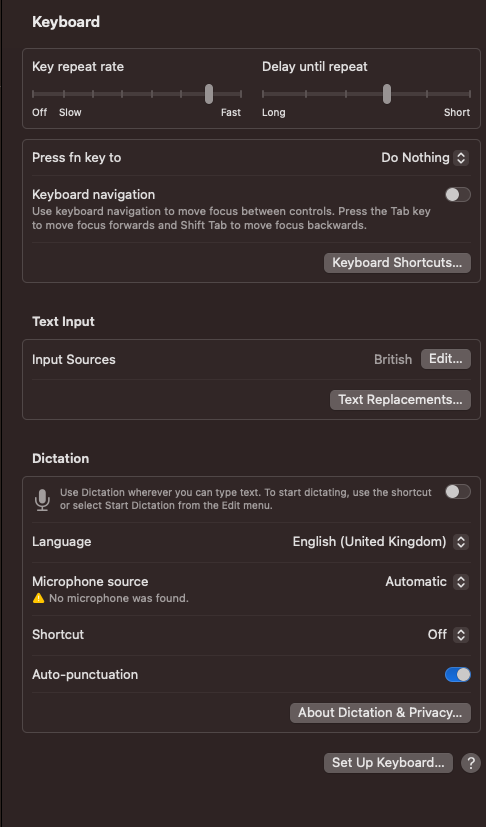

Hi, can someone please help me with this issue I am having.
I have a Logitech MX keys Keyboard (for Windows) and I am using it for the Mac.
I have set my language to UK however my @ key is on the 2 key and not where it should be (or what I am used to) being next to closer to the enter key.
any ideas what settings I specifically need to change?
T

You can switch to “British-PC layout”, restart your Mac and the keys should be working as you want them. I did this with Corsair K60 Low Profile and everything maps correctly.
Thanks but where do I do that? I have already set it to UK above
In System Prefs/Keyboard select the 'Input Sources' tab,
bottom left, click on the + button,
then select British > scroll down to 'GB British PC'.
Then click Add and select it.
(That's in Monterey, but I assume Ventura has a similar process.)
Reactions: AlphaCentauri
Exactly that. I’ll just add that for me, this only worked after restarting Mac. Before restart, it was selected but layout did not change (Intel mini and Ventura).
