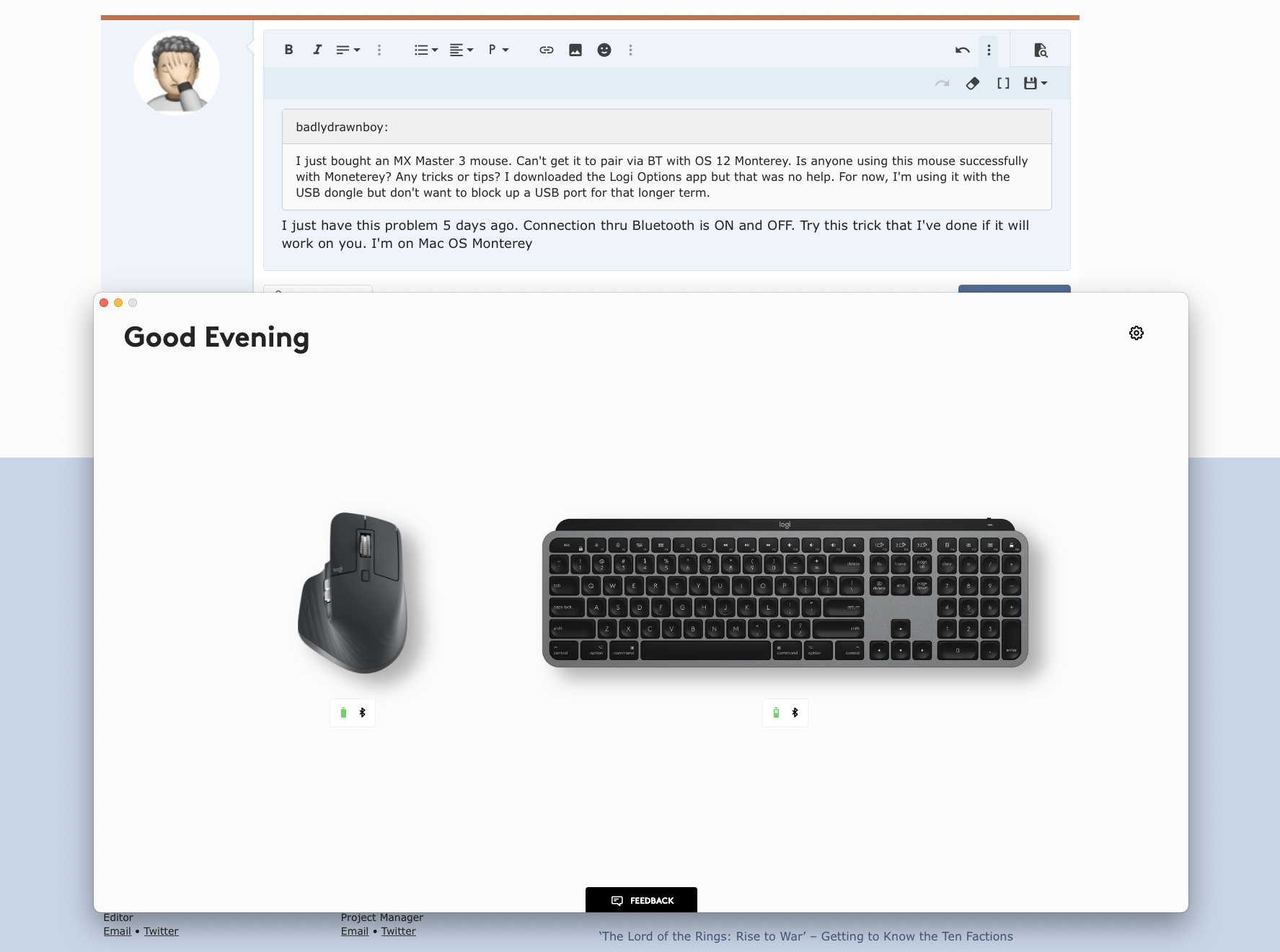

I just have this problem 5 days ago. Connection thru Bluetooth is ON and OFF. Try this trick that I've done if it will work on you. I'm on Mac OS Monterey too.
Delete any App related to its driver, log out and install Logi Options+. I'm on my second day of no-disconnection-via-bluetooth. Goodluck.

Thanks. I wasn't able to pair it via BT before OR after installing Logi Options, so I don't think it has anything to do with the driver or apps related to it.
