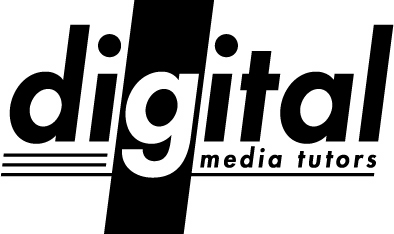

LeeTom said:
Also, be aware that DMT is an illegal psychadelic drug.
with that in mind...
this is very rough and needs fixing, btw...but it might be a better solution. Your DMT with the overlapping letters isn't quite working so well as it might.
