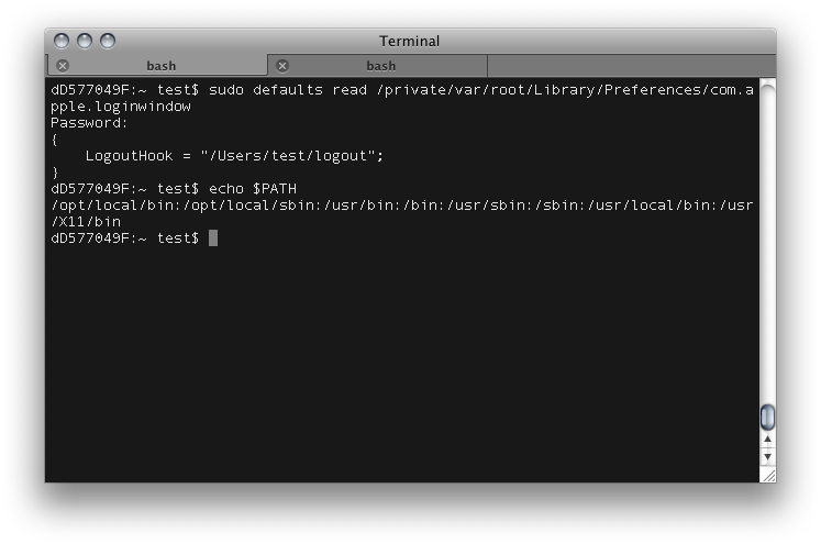

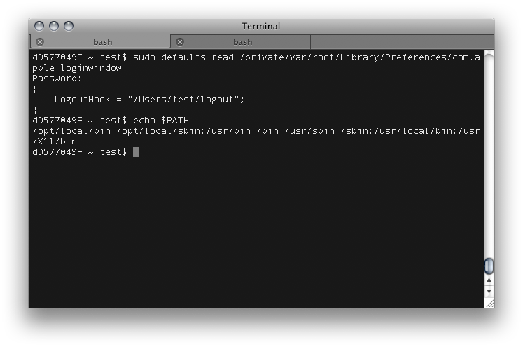

2) If you do your sudo defaults write command what do you see when you do sudo defaults read. What do you see when you do echo $PATH. Is /usr/local/bin in your PATH. If not your shellscript will not execute.
3) Does the folder /users exist? Shouldn't that be /Users.
4) You might run into trouble with spaces. Read this : http://developer.apple.com/library/mac/#technotes/tn2065/_index.html

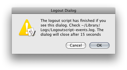

Contents of the LogoutDialog.scpt Applescript. Nothing fancy it just deletes a folder named Postscript located on my Desktop and shows a dialog box at the end. It also does some logging to see what the script did.
Code:
set commonScript to load script alias "LeopardFirewire:Users:test:Library:Scripts:Common code.scpt"
set the_user to do shell script "logname"
set the_user_list to {"test"}
if the_user is in the_user_list then
	try
		do shell script "rm -R /Users/" & the_user & "/Desktop/Postscript"
		log_event("Removed the Postscript directory from the Desktop of user : " & the_user) of commonScript
	on error theErr
		log_event("Error occured : " & theErr) of commonScript
	end try
end if

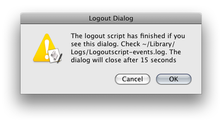

tell application "System Events"
	activate
	display dialog "The logout script has finished if you see this dialog. Check ~/Library/Logs/Logoutscript-events.log. The dialog will close after 15 seconds." with title "Logout Dialog" with icon caution giving up after 15
end tell
I logged out 2 times. The first time it removed the Postscript folder, the second time it errored because the Postscript folder didn't exist anymore.

In the Console application in All Messages I see the following for
The first line in my log :
15/06/12 20:24:45 /System/Library/CoreServices/System Events.app/Contents/MacOS/System Events[1243] OpenScripting.framework - 'gdut' event accepted from process "osascript" (pid=1238 uid=0 euid=0) with different owner than (uid=501 euid=501)
15/06/12 20:25:00 com.apple.loginwindow[1107] «class bhit»:, «class gavu»:true
The second line in my log :
15/06/12 20:25:56 /System/Library/CoreServices/System Events.app/Contents/MacOS/System Events[1315] OpenScripting.framework - 'gdut' event accepted from process "osascript" (pid=1310 uid=0 euid=0) with different owner than (uid=501 euid=501)
15/06/12 20:26:11 com.apple.loginwindow[1248] «class bhit»:, «class gavu»:true
