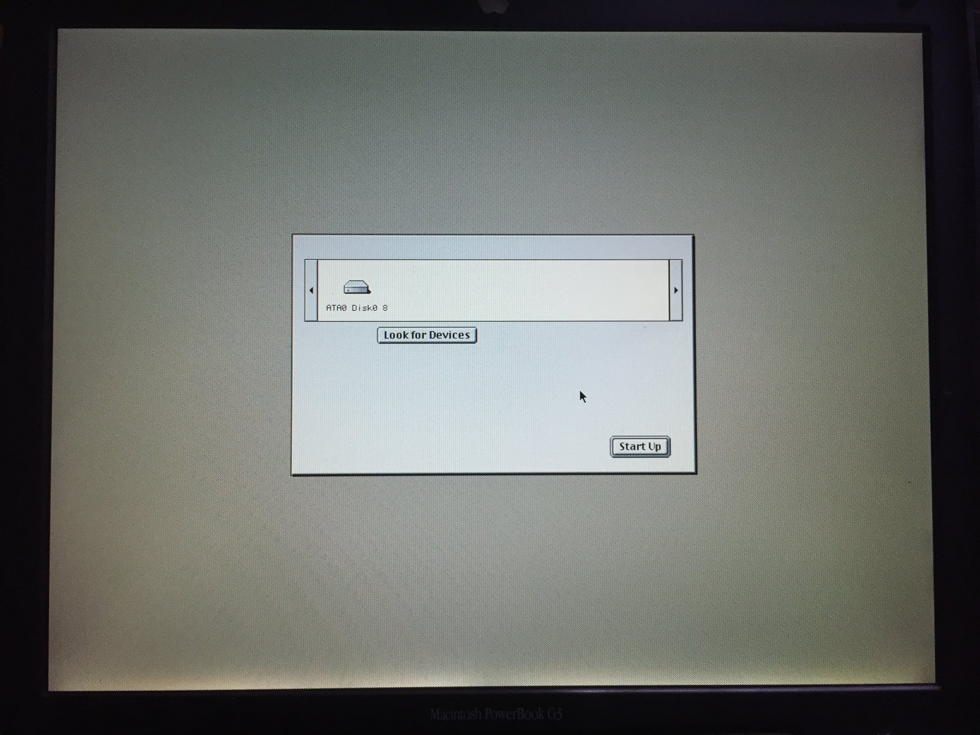

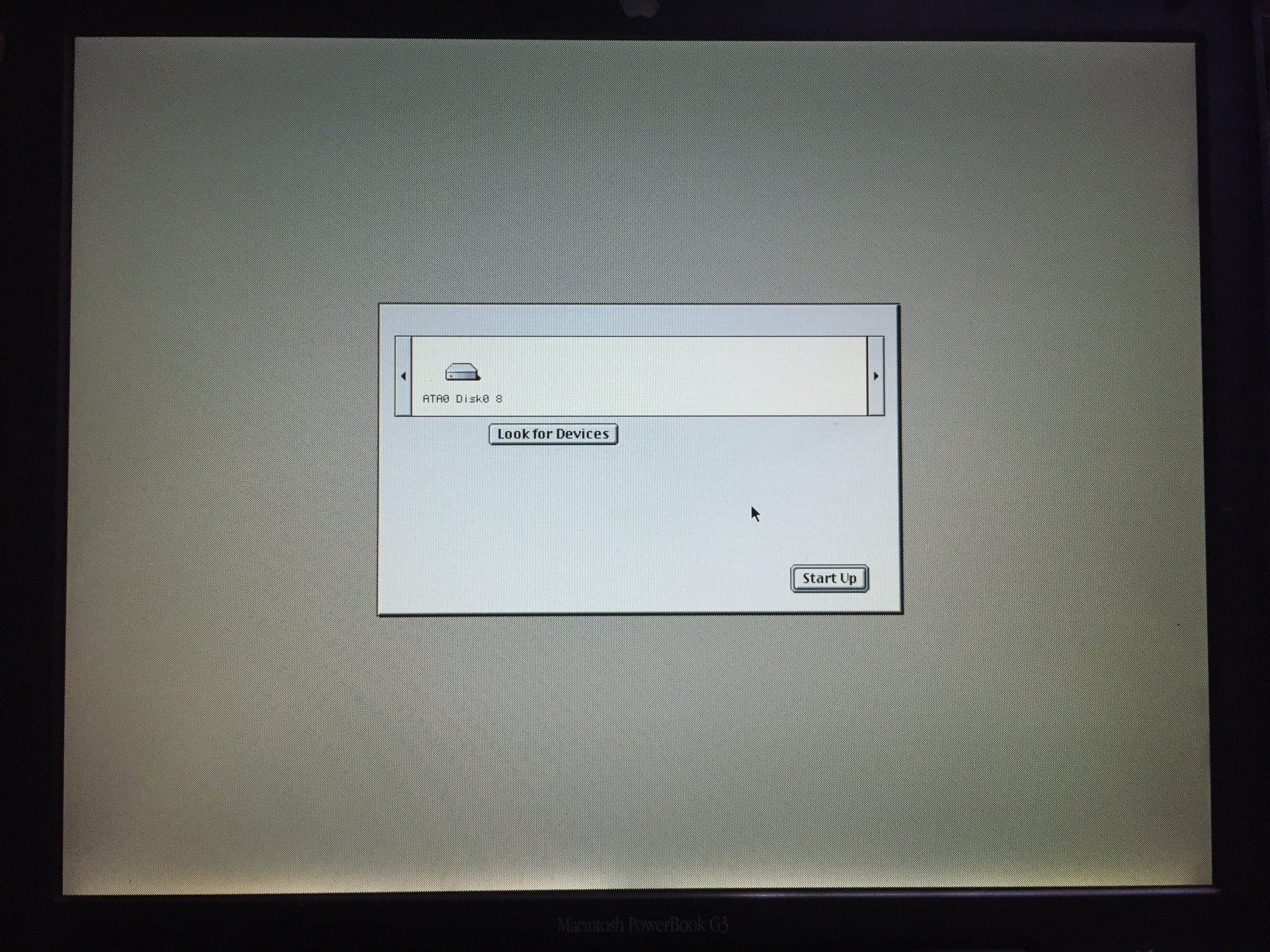

The Lombard has no option-key boot selector, but if you drop into open firmware (cmd-opt-O-F), then enter ‘multi-boot’, you’ll see the boot selector menu (same as the PDQ). Unfortunately USB devices are not recognized here.

Curiously I tried the USB install route on my Lombards and found that Open Firmware does not recognize the usb disk device at all (no visible usb > /disk@1 in the ‘dev / ls’ output).
Also, XPostFacto does not recognize the install USB as a bootable device.
Excuse the poor image here. My 2nd Lombard suffers from LCD panel deterioration.

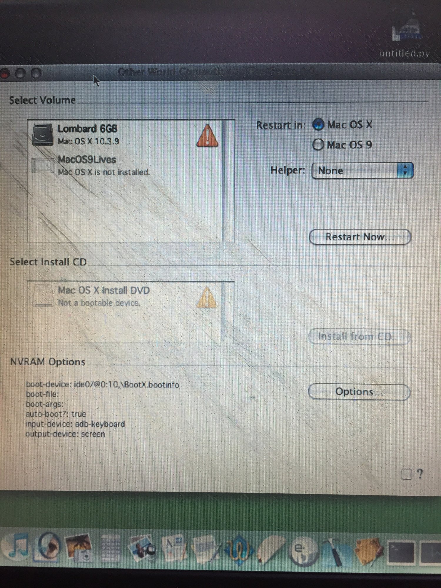

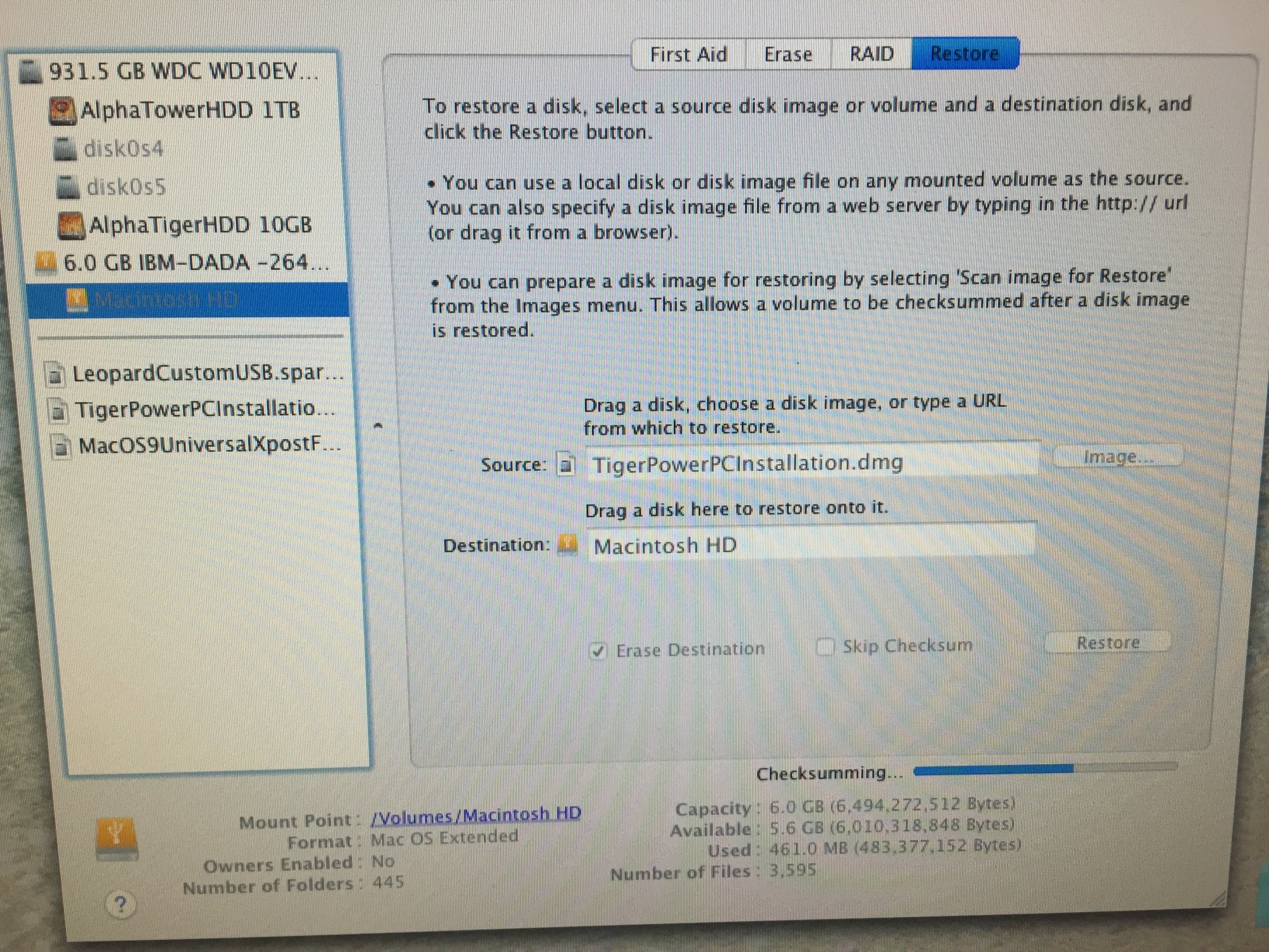

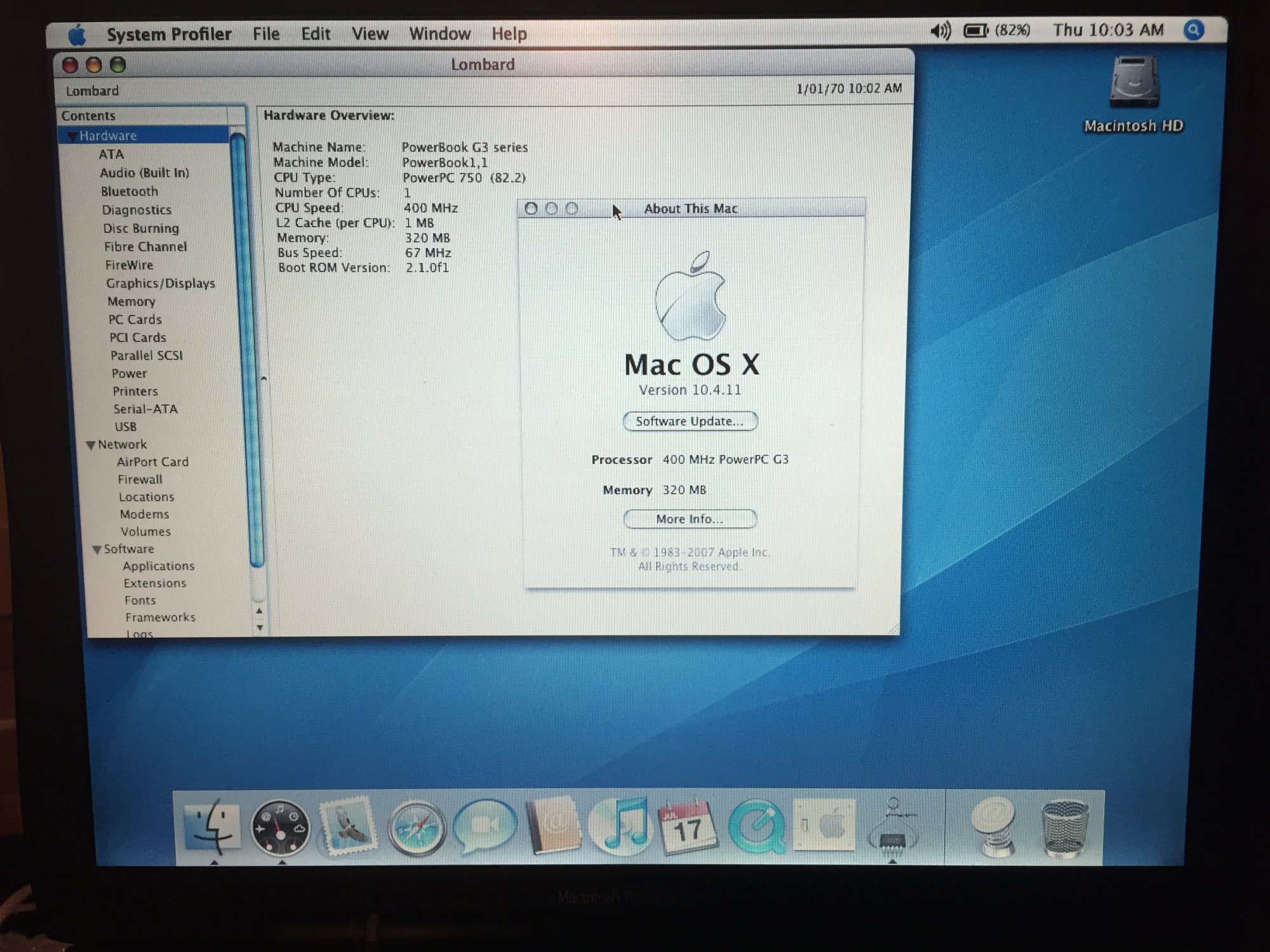

So I tried installing Tiger from DVD via XPostFacto4 in Mac OS 9, but was greeted with the gray circle with a line through it every time. I then tried spoofing the machine id as a PowerBook3,1 via OF but then it refused to boot at all...

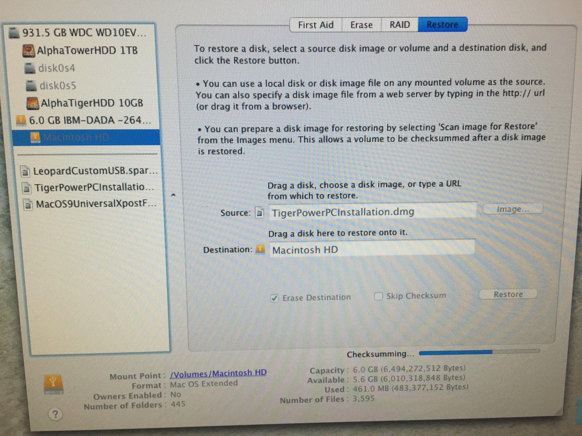

In the end I took my own advice and just removed the HDD, hooked it up to my G5 via a USB adapter and then used Disk Utility to clone a clean 10.4.11 installation onto the 6GB HDD. I then copied Mac OS 9.2.2 System Folder and Applications (Mac OS 9) onto the Tiger drive to be able to boot between OS 9 and X.

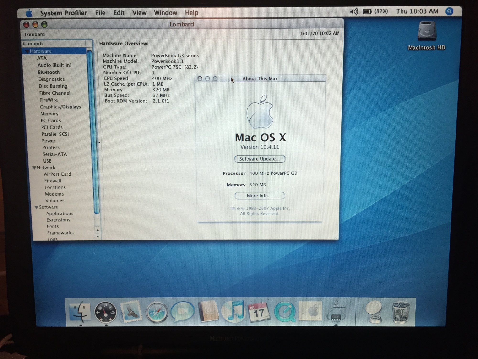

While I had it open I also upgraded the RAM from 128MB (2x64) to 320MB (after hunting around for a low density 256MB SODIMM).
Tiger then started up promptly on first boot. No problems.

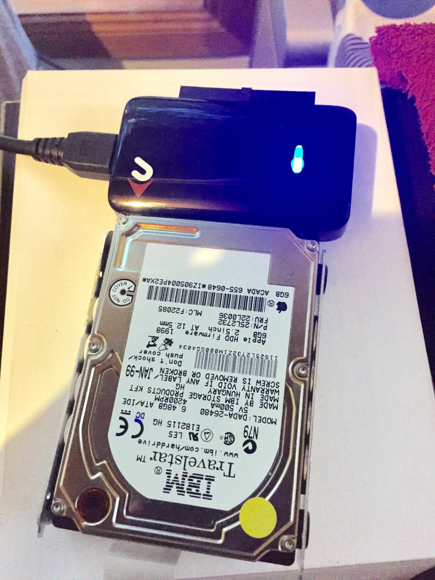

What is the USB / hard drive adapter you have there? That looks pretty handy.
It’s a newertech usb 3.0 universal drive adapter. It was a bit pricey when I ordered it from OWC a few years back, but I have seen generic ones on eBay for around $25.
It does SATA and PATA 3.5” and 2.5”. The 2.5” (44pin) side is powered over USB which is handy, otherwise it includes a transformer for molex and SATA power.
