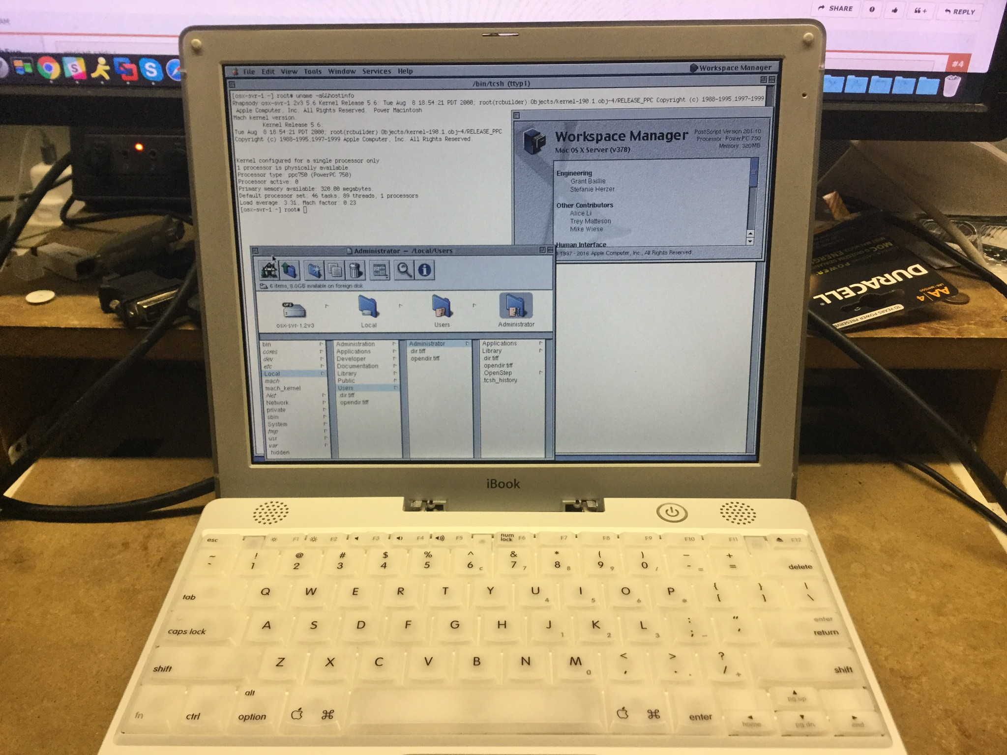

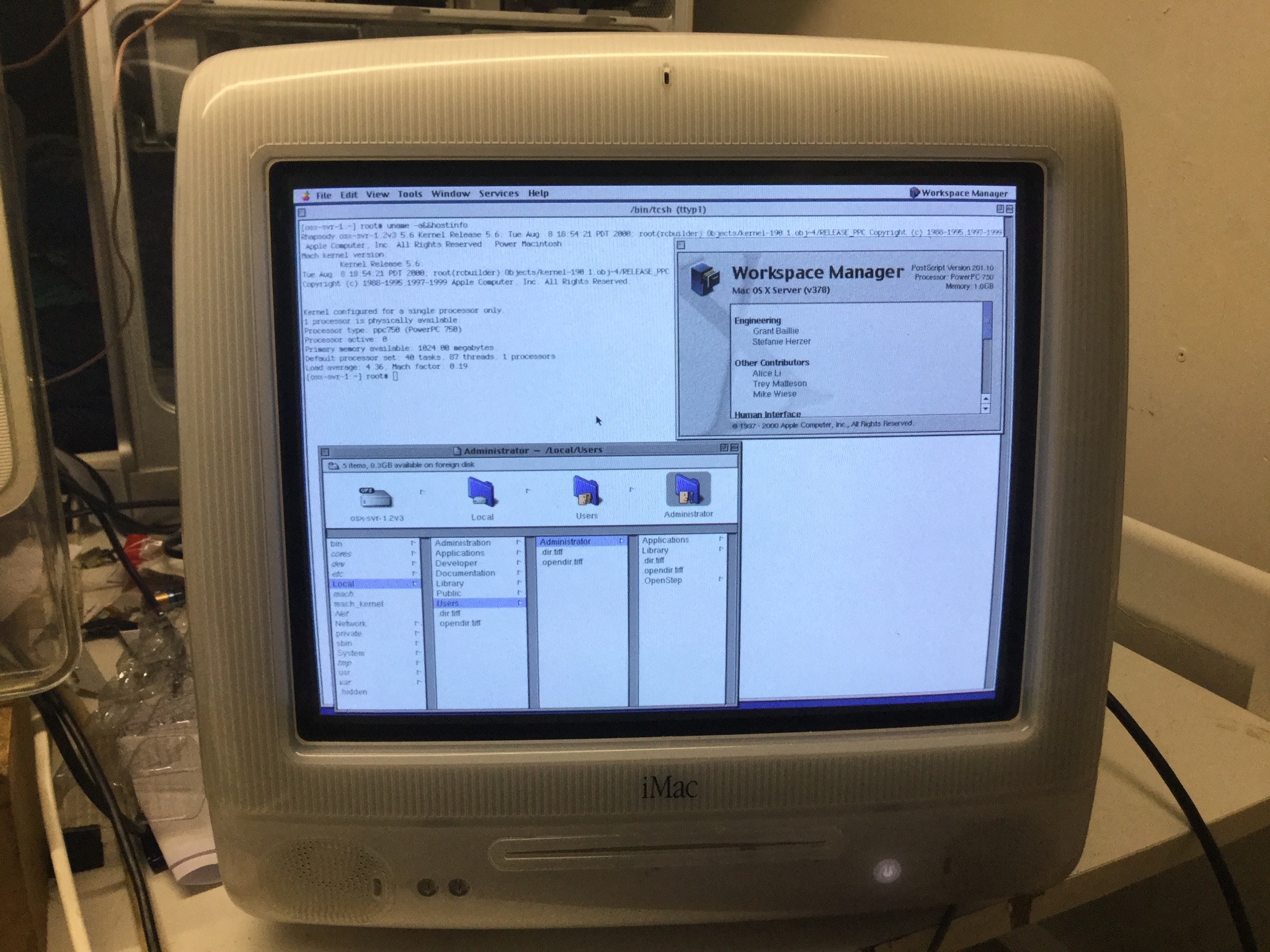

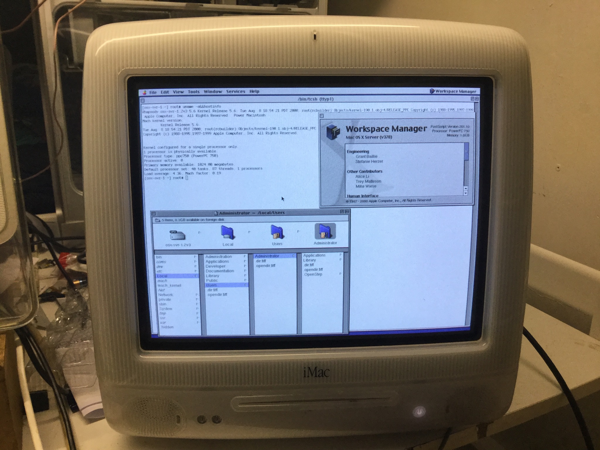

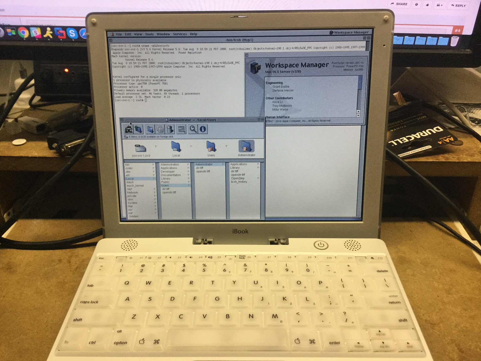

BTW: I installed Mac OS Server 1.2 (Rhapsody) on one partition.
https://www.mediafire.com/view/bnw2xm44hcjbct6
I did manage to hack OS X Server 1.2V3 onto my dual USB iBook G3 heh as well as my flower power iMac
