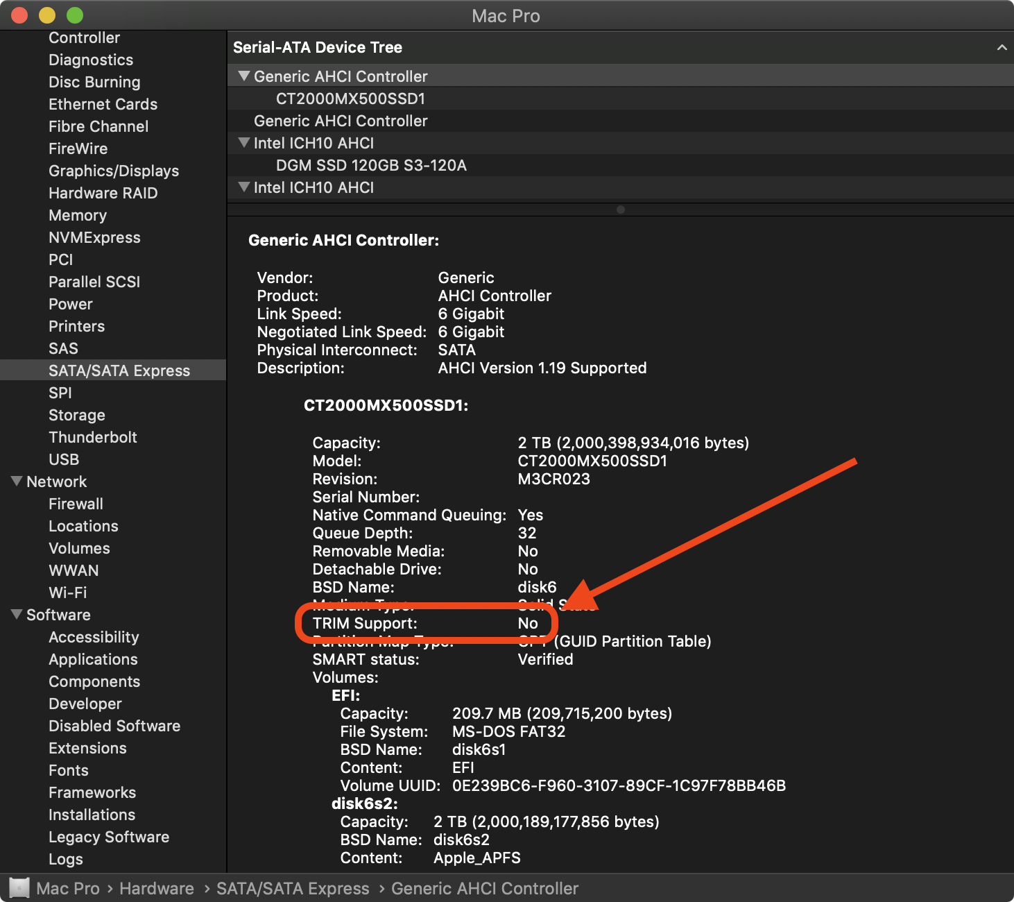

The SSD is formatted to APFS, but I’m unfamiliar with TRIM. What steps would you suggest?
**EDIT** For reference, the boot time is currently 4 min and 54 seconds.
Check here to confirm TRIM support
Reactions: ZeroKool79
Thanks so much!

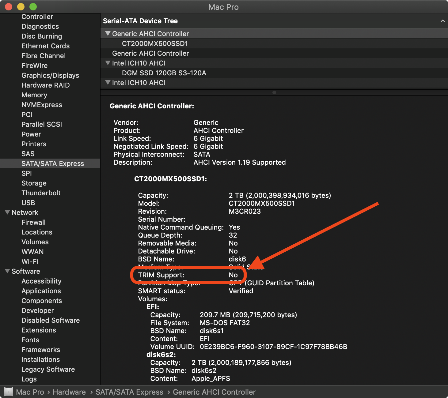

My system report says: TRIM Support - No
Is this a good or bad thing?
I've tried configuring the boot disk to Mac Journaled Extended with no luck as well.
you mean a clean HS no a HFS+ formatted SSD still boot that slow?
Sounds like either the SSD itself is failing, or you are actually booting from another HDD.
