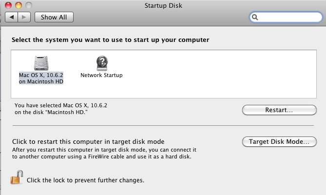

have you selected the start-up disk in system preferences?
