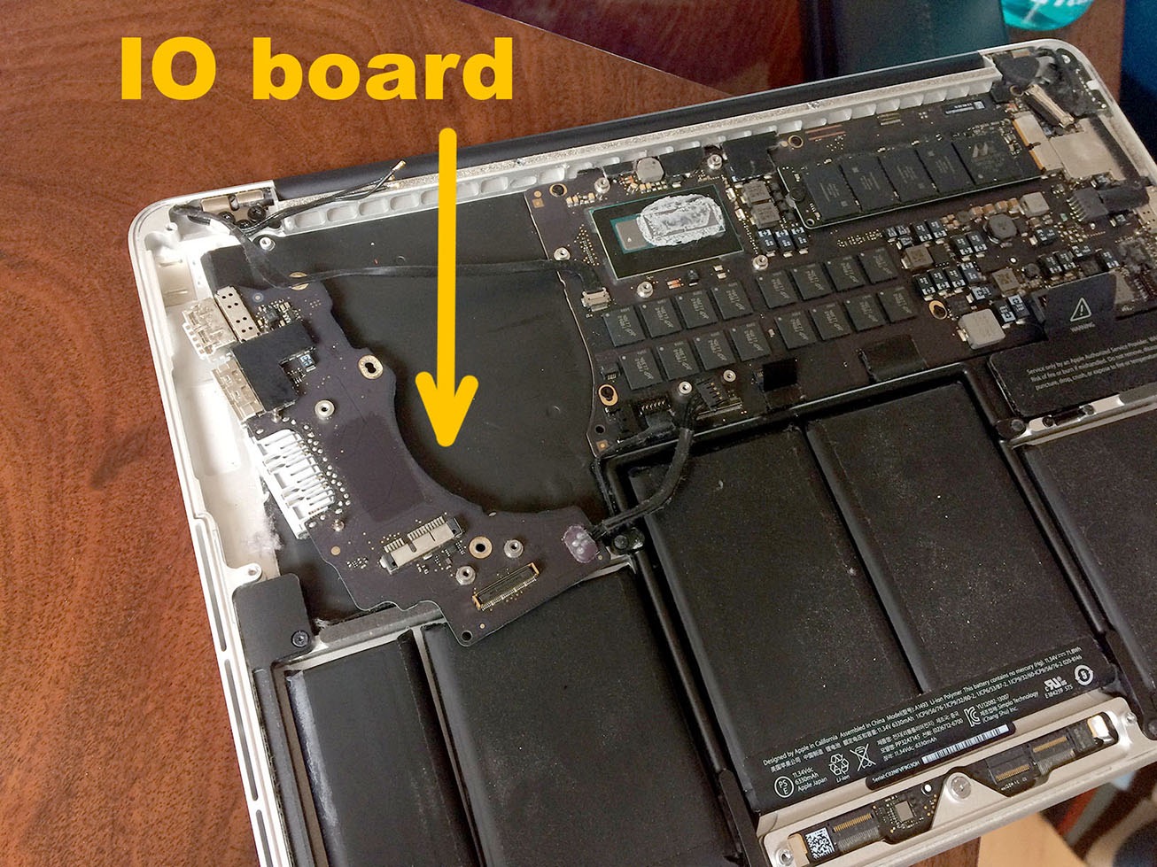

Anyway, I took the cover off to have a poke and discovered that if I disconnect the IO board, it boots immediately as expected. I am assuming there is a bad connection or even a short somewhere on that board. We'll find out soon enough, that part is the interface for the 2nd USB, HDMI port and SD card reader, so it kind of make sense. A bad connection to a peripheral can generate this sort of glitch. Picture with the board below.

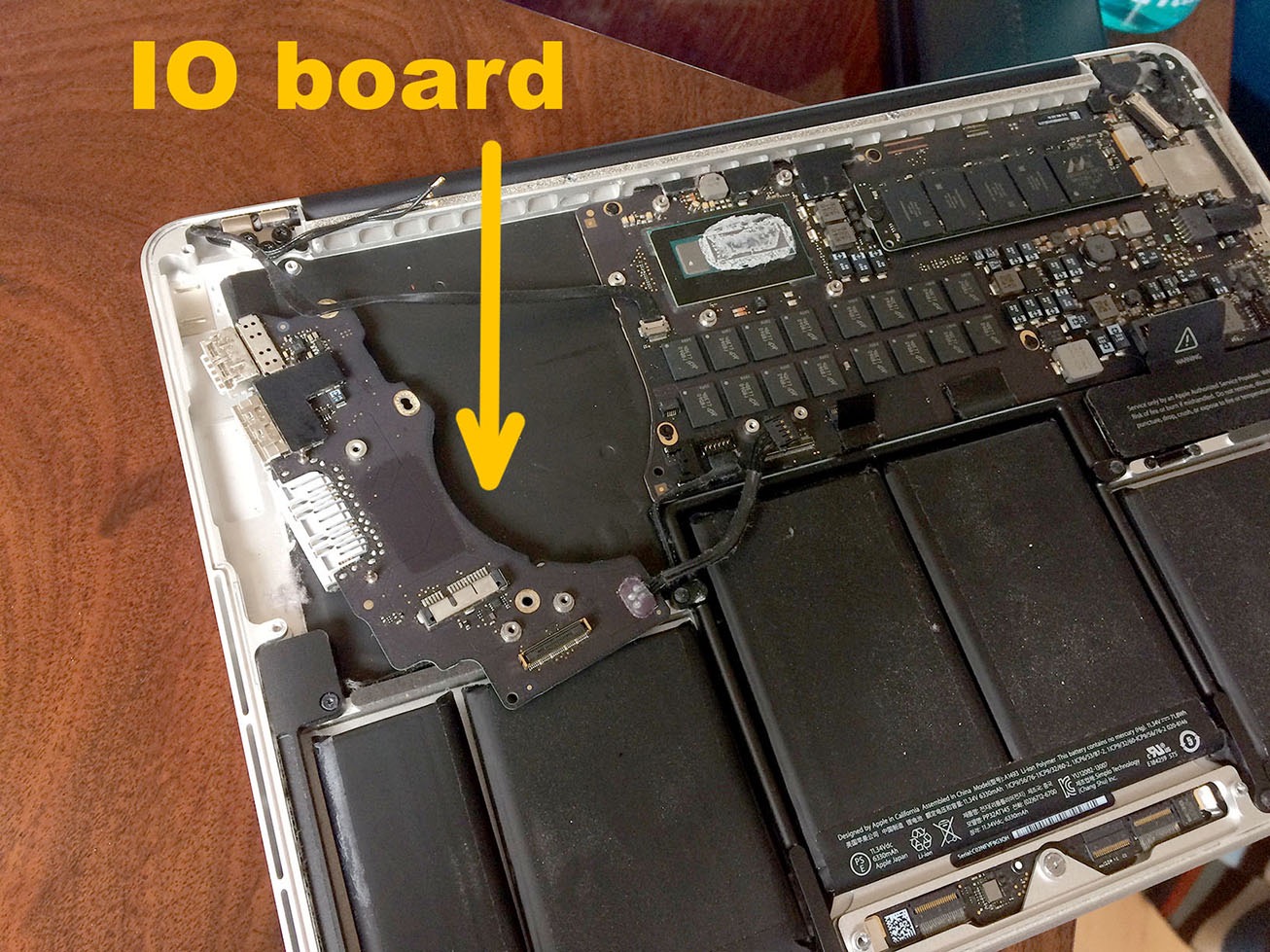

this part is pretty cheap, don't forget to replace cables
Good point about the cable, in this case the fault was indeed somewhere on that IO board. Replaced the board with a second-hand one, it was under £20 off eBay. All sorted now, thanks everybody 🙂
