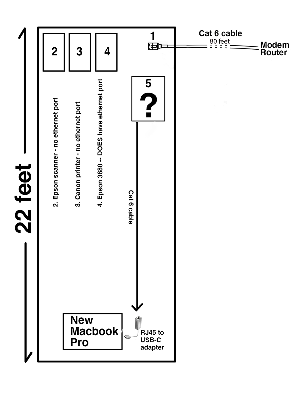

Fail! My solution is not stable. So I’m gathering that an ethernet connection of some sort is the way to go, but I don’t know anything about how to do this (and I’m not too tech savvy to begin with). I’ve attached a diagram of my room. Unfortunately, this is the way it is – the computer is on one side of a long room and the printers, scanner are on the other. My diagram is just a guess, so maybe several errors, but the main thing is I’m not sure exactly what type of hardware is #5. I’m guessing that 1, 2, 3, and 4 go into #5 and then an ethernet cable runs out of #5 over to the computer. Is that correct, or am I way off? And as the scanner and one printer have no ethernet ports, I guess I need 2 USB female to RJ45 male adapter, is that right? Appreciate any advice.
