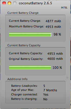

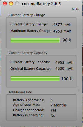

What's your battery health? (you can check with coconut battery)
Looks like 95% health with 98% current charge. I could let it drop below 95% charge and recharge and see if this changes at all.
It also claims that the battery is not currently charging, which is what I believed to be true due to the green light on the AC adapter.
-jt2

From what I notice, if you leave it charged at 100%, it doesn't stay there. It drops slowly to 95% over time, then the charging keeps it again. So it looks like even if you were connected 24/7, there is some sensible cycling going on.
It doesn't try to keep the charge at 100% but lets the battery lose its charge slowly and then bumps it back up. See attached... notice its not charging?
