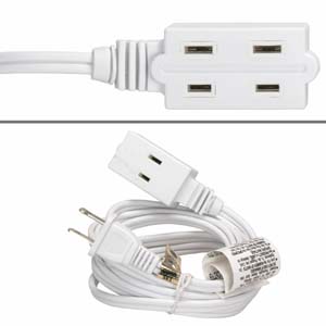

I'm really ghetto. I just plug the power brick onto one of these. Works great!
