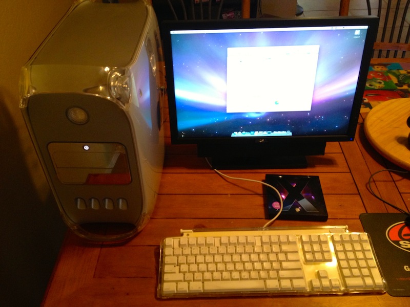

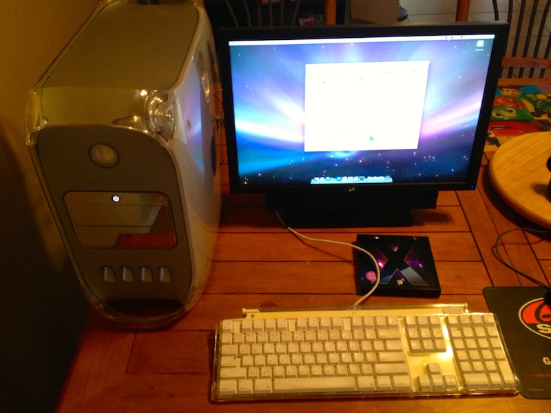

It had no hard drive or ram when I got it. I also swapped the SP1.25 with a DP1.25 I received from another member here. It keeps kernel panicking, so I will reinstall OSX.

Welcome to the MDD club 🙂 I use mine daily for iTunes and ten four fox. Max the ram and get a video card that supports core image and it will eat leopard for breakfast.
I rummaged around and found a pair of one-sided 512mb pc-2700, but osx sees it as pc-2600. I'm goin to look through my spare vid cards to see what I have, but I suspect the 9600 it came with is gonna be the best.

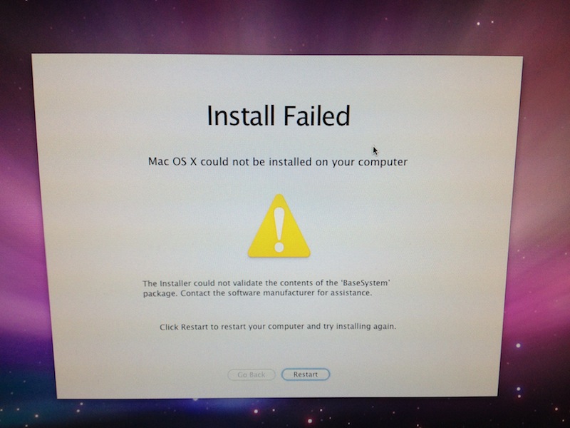

I'm beginning to think the optical drive is no good. Both my leopard disks pass verification, but install fails at installing base system. I need to look for a DVD player.
Errors 🙁

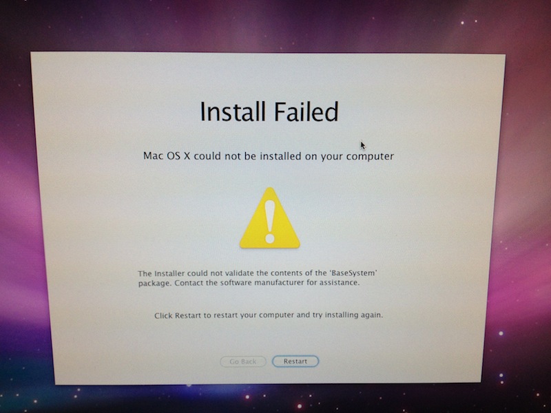

I keep getting the following error. Ive tried multiple hard drives, multiple optical drives, two different leopard discs and a tiger disc.
Suggestions?

Do you have a firewire drive?
If so I would just create a disk image of your Leopard Installer and install it from the firewire drive.
or partition a Mac with firewire and restore the DVD to that partition and install from there in target disk mode.

I've hooked up my iBook as a target disk mdd and am copying the OS to the dive on th mdd.
Here's a stupid guess, and I may be totally wrong and ridiculous, but...
Have you replaced the PRAM battery? Perhaps it has an erroneous date code, causing the validation not to work. I'm not sure where the time comes from when booted from the OS X install DVD. I know to install iLife recently, I had to set the date to pre-2012.

It ended up being bad ram. Now I just need to get some Ram for it 🙁

The 9600 should yield better results then the stock 9000 I have installed in mine. Still on the hunt for a better graphics card. My 9000 is pretty taxed pushing my 40" LCD.

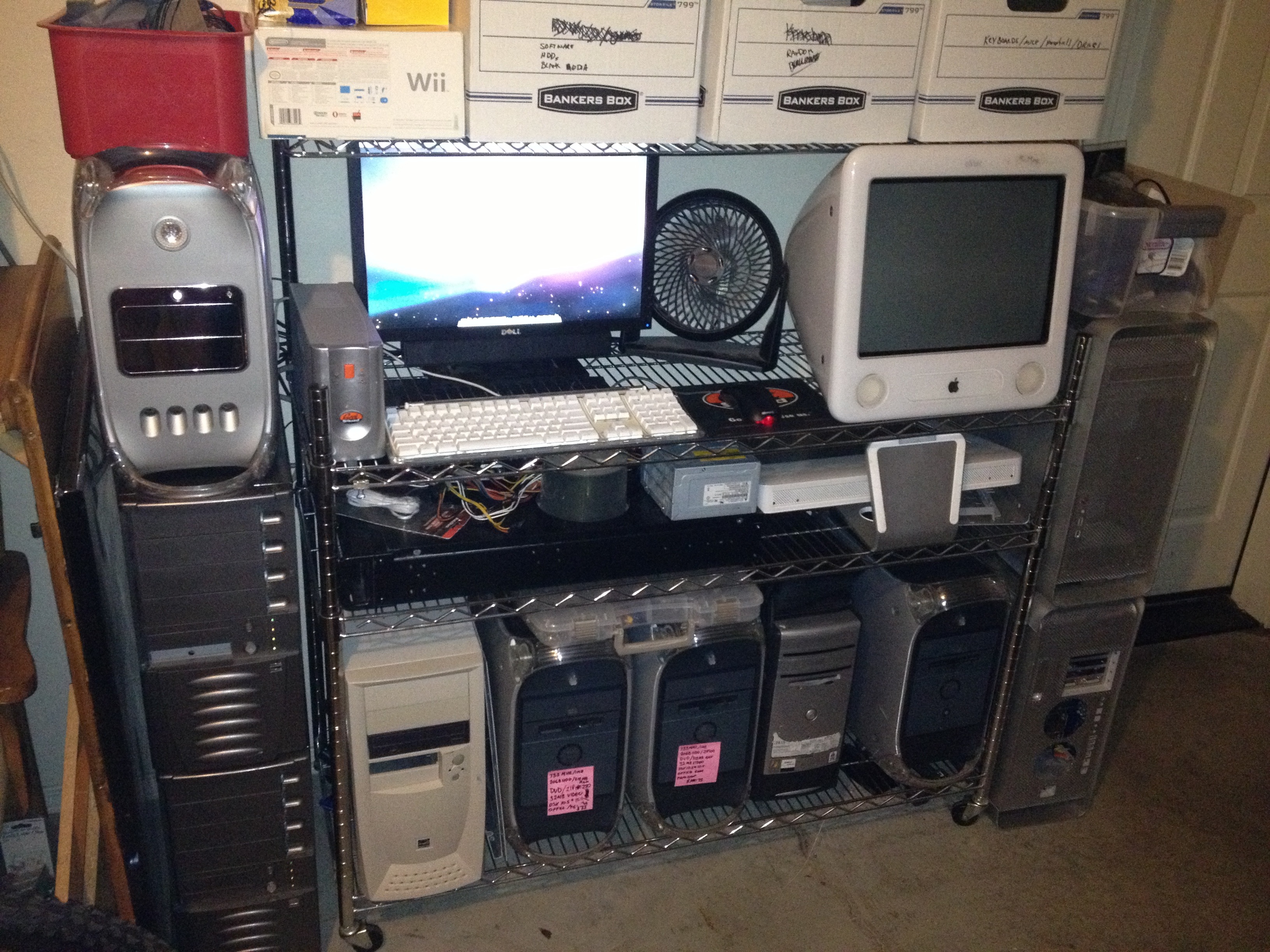

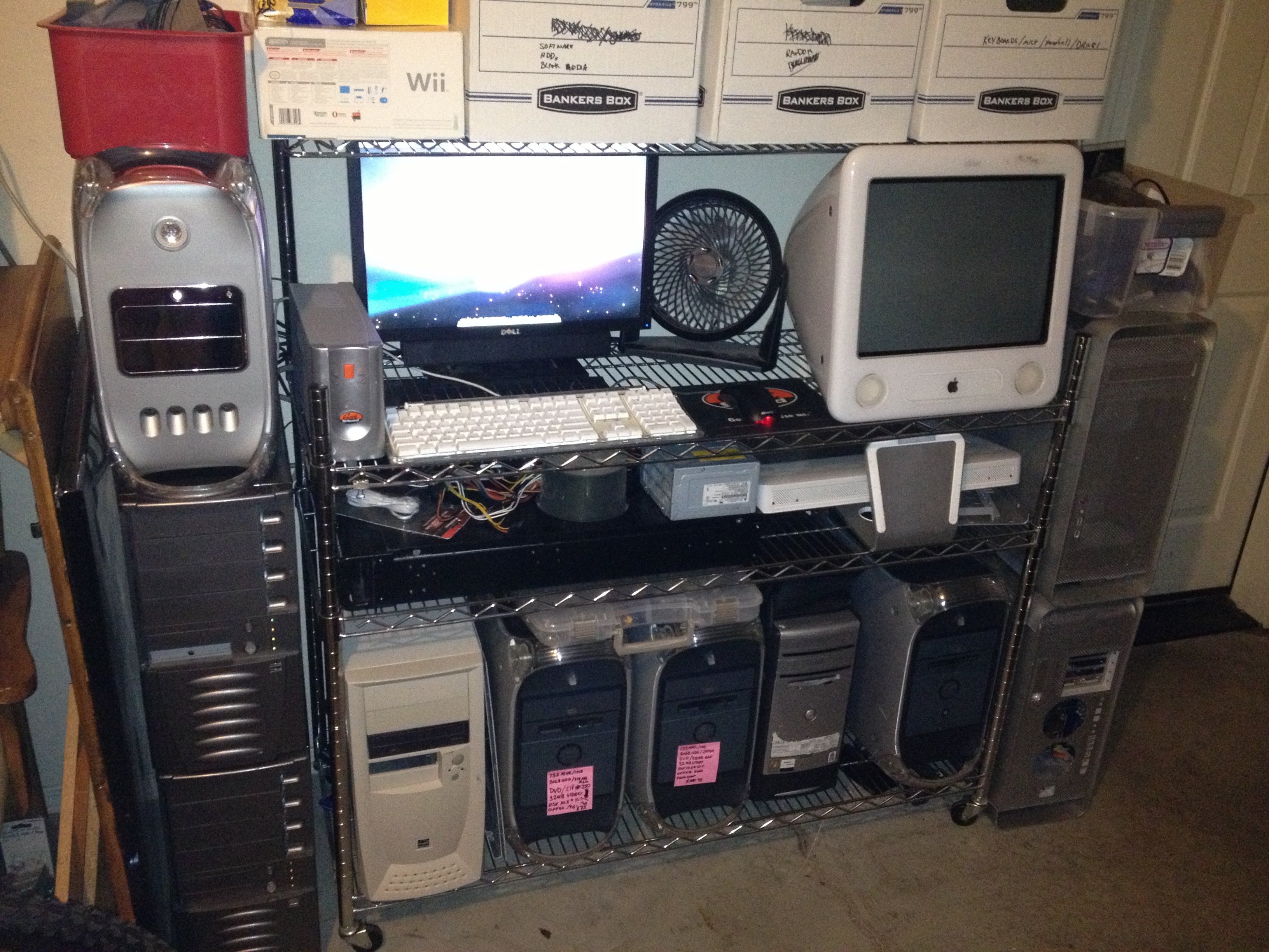

After reinstalling everything and spending a few days on the dining room table, my MDD has been banished to the garage. This image looks nice, but only the MDD, eMac and two of the Digital Audio actually work.

That looks just like the one I've got. After you swapped it's processor configuration, we both share the same processors. I'm not sure about RAM, Graphics and hard drive now but they might also be the same as well.
If it's a Mac I'd easily take it even if it's missing RAM, Hard Drive and Graphics. I've got enough PC's so I'd just leave them.
Cool find! Did you say how you found it?
Suggestions?
You can try resetting the PRAM. Close to the lower front of the logic board inside the machine is a little button. It should be labelled "PRAM". Only give it a quick press, don't hold it for more than 2 seconds!
I have to press this button because sometimes mine fails to turn on when I press the power button after it's been unplugged for some amount of time. So, I can press this button and then power on the machine and it's good to go for a while. For me, this PRAM reset button fixes pretty much every problem I have with my MDD, aside from occasional random lockups then Kernel Panics.
