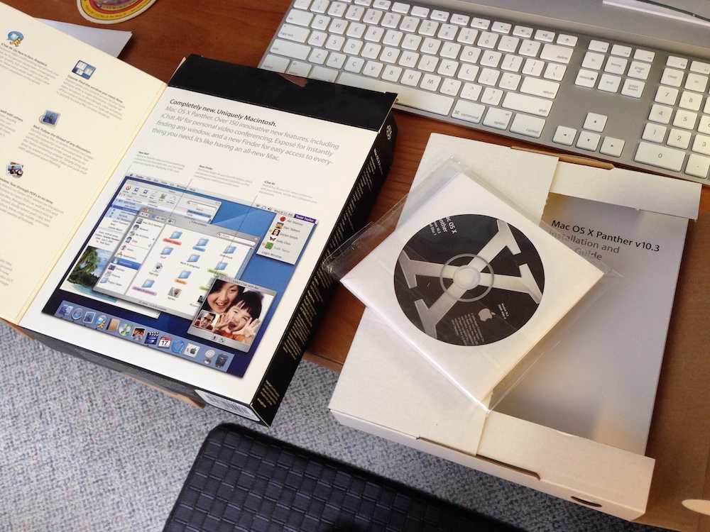

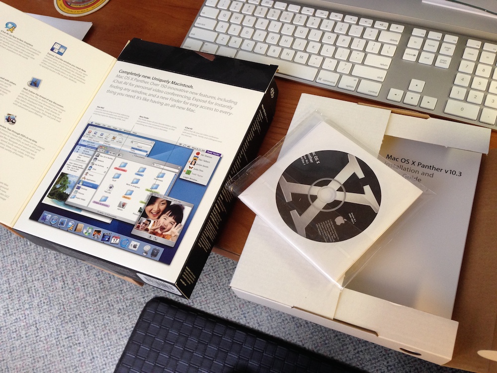

Like this?
I might be able to mail you the discs if you promise to return them when you're finished and pay for postage.
