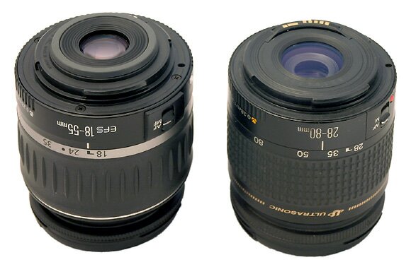

OK just to clarify things- EF-S lenses are designed for FOV crop cameras on Canon. The "S" stands for short back focus, and EF-S lenses are compatible with all Canon DSLRs, save for the 5D and MK-1s (not sure about the MK-IIn). They are not just smaller, their mount is different. They will not work with 35mm cameras.

All of Canon's film SLRs (in the EOS series) use the EF mount. So too do the EOS 1Ds series, the EOS 1D series, the EOS 5D, and the EOS 10D. The other EOS cameras (300D, 350D, 400D, 20D, and 30D) use the EF-S mount.
A camera with an EF-S mount point will accept EF lenses. A camera with an EF mount will not accept EF-S lenses. They physically will not mount. This is because EF-S specifies a mirror size that is smaller than that allowed for EF, which in turn means that an EF-S lens can have elements that protrude further back than an EF lens.
if you do manage to mount an EF-S lens on an EF body, it is liable to collide with the mirror as it swings up, causing damage to the lens, the body, or both. It can be done safely on the 10D if you modify the lens, but Canon officially discourages such a practice.
If you have a Canon film SLR, and you're planning on getting a 5D, probably the best wide-angle lens to get is the 17-40mm f/4L. It'll mount on any EOS body, and is excellent value for money. The 16-35mm f/2.8L, I'd only recommend if you have a need for the faster glass. It won't be particularly wide on a crop body (one that accepts EF-S glass), but it'll do a fair job for the interim.
The rest - about the reduced image circle, and so forth - is correct, though.
sjl is right, an EF-S mount lens won't mount on a EF mount. However an EF lens will mount on an EF-S body. On a full frame body the mirror will hit the back of an EF-S lens.
You can see how much deeper the EF-S lens is here (EF-S is on the left)
BTW, I'd suggest the 17-40. Its a nice lens on a 1.6x body, and you'll really enjoy it on a film body or FF digital.
