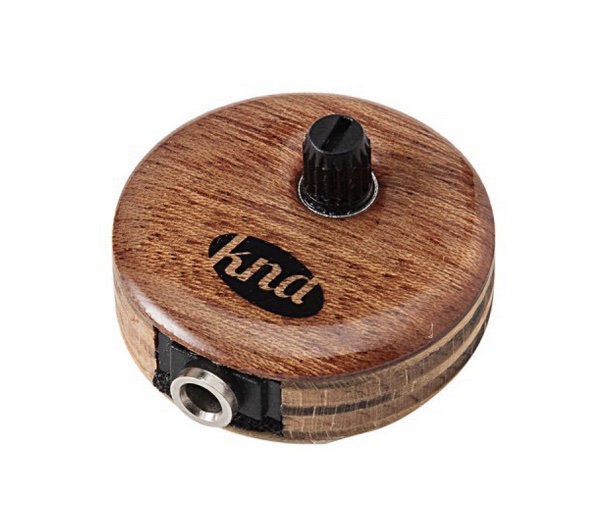

KNA, the one with the knob.

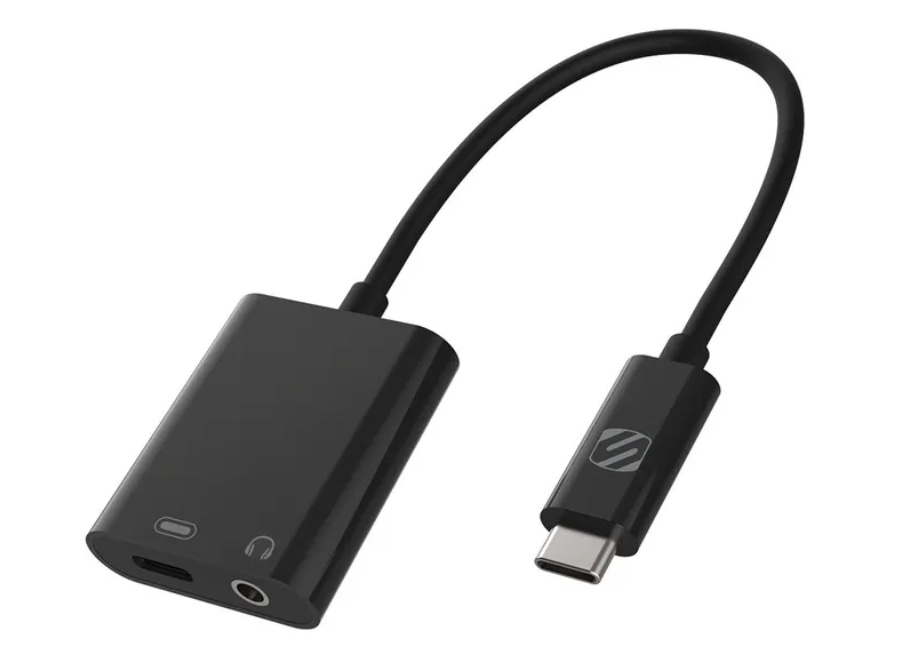

I found a Scosche adapter model CAAP-SP that seems like it might work. And got the royal treatment at Staples, paying $43.00 for something listed for $40.00 on their own store. Oh well... Haven't hooked it up yet. Supposedly it works on iPads and the sales droid mumbled that 'It works on Apple'. Okay...

What you have is a KNA piezo instrument pickup.
Yeah…you haven't hooked it up to that yet. Because when you do you'll find out it's not what you need.

I can't. I need a 'contact microphone' to record the bearing noise I'm experiencing. A 'normal mic' won't do.
Basically I have to, as an analogy, convert an acoustic guitar to electric. The support 'engineers' want to HEAR the noise that the bearings seem to be making. I've got round and round now trying to get this done. And like @BrianBaughn said, this isn't what I need, or more precisely, I need MORE than I have.
The KNA needs a pre-amp to be able to be heard by any audio interface. And the Scosche isn't a great device to do it either. Directions are nearly completely nonexistent. Their support said 'plug it in, and it works'. Well, it's not that easy. Some software would have helped, some software recommendations would be even more helpful. I may have to buy/borrow/steal a more 'commercial quality' audio interface. Oy!!
It's almost comical that it's turned out to be so difficult. (I even thought of borrowing an electric stethoscope, but those things are eye wateringly expensive and I doubt someone would let me borrow one. I wouldn't!😳😎)

Apparently I need a pre-amp for that mic. I didn't figure that into the process, and was actually hoping to avoid needing/using one.
The interface you got doesn't seem to me to have an input at all. A headphone jack is an output.

On the website, that Scosche 'thing' is being marketed as an interface for iPads/iOS to use with mic'ed headphones/headsets, so it's bidirectional/ambidextrous. The KNA is just what I was looking for, I just need more to make it work. Worst Try has nothing in stock locally, and the Geetar Center is kinda skimpy too. But, unfortunately, I have to shelve this for a bit and will get back to it. It's still so crazy to me, for some reason, how complicated this is getting, but then I'm not a sound engineer or musician either. 'How would normal people know what to do?' Apparently nothing about this is anywhere close to 'normal', which is a place I should feel much more comfortable being in. 😎
