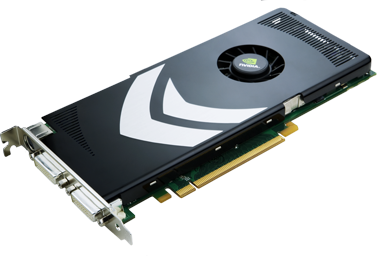

Hi mates, i'm looking for a 8800gt for my mac pro 3,1 because of the boot.
I also have a GTX570 as a second card. If you think in a better card as a first card, i mean to have boot screen, tell me which one are you thinking at.
Do you know if this model works fine?
or only this one?
Not very sure what do you mean about "because of boot". You need a card that can boot in OSX? Or a card that can provide boot screen? They are difference. If only need a card that can boot in your 3,1. There are plenty of options, and almost no reason to get this 8800GT.

I mean a card that provides boot screen, so i can use recovery or test options.

8800GT is not for performance, is for getting boot screen, i can buy the 8800GT for 12-17$ and the GT120 is a rarest card here in Spain so it would be more expensive. For Performance i would buy a GTX570 (around 70$)
Watch out with buying an Apple 8800GT as they are plagued with overheating problems that desolder the GPU die.
Unfortunately i think all the nvidias has that plague, but i think ATI is worst, ATI is mordor
It was due to using lead free solder, which when heated to the 8800GT's running temp, melted the solder which lead to hairline cracks making the die move slightly :S

The other reasons the 8800GT failed, which you stated, is the very poor airflow with it being a single slot card. If you are able to get the dual slot, go for it as the airflow is much more efficient!
another thing i'm thinking is about the power wires, i have 2 power wires on my mac pro 3,1. if i put the 8800gt that has 1 power cord, then i cannot connect the second GPU 570GTX that has 2 power cords.

buy an power supply and pull out one extra pci brackets out and route the cables thro there if you relay need it
or you can hard mode the mac, but thats not simple or easy

Watch out not all 8800GT's can be flashed some EVGA and others can but only if it has the larger rom. Better option get a GTX680 and flash it its a much better card
Yes, if you get a flashed one, or flash it by yourself. There is a EVGA GTX680 Mac Edition card (have boot screen natively on Mac), but they are very rare now, hard to find, and most likely way over price.
because of that is better to flash it. but it bought a gtx570 thinking that it can be flashed to get boot screen but someone told me that i cannot do that.

as far as i know the GTX 680 is one of the only nvidia cards you can flash easily, there are a bunch of ATI cards that can be flashed too
