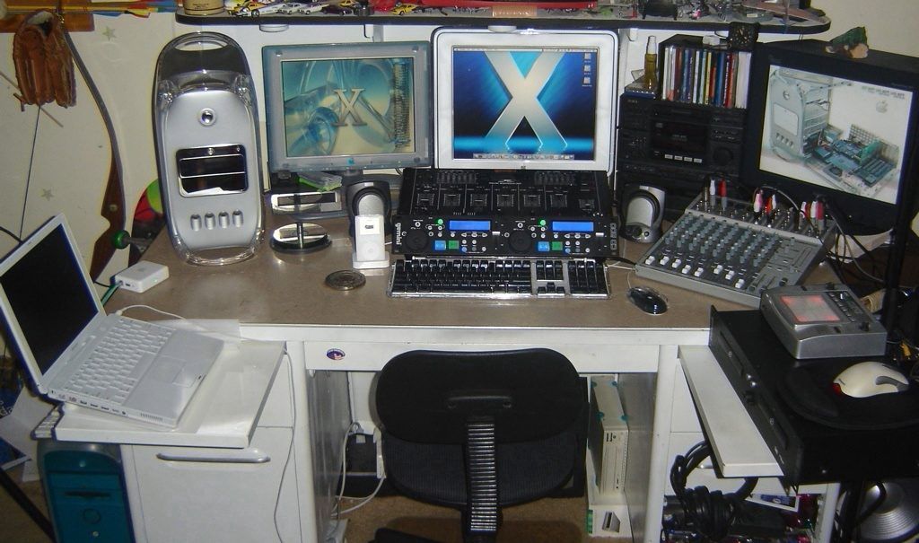

I've found that, with Behringer equipment, you get what you pay for. If you pay $50 for it, you'll get $50 quality. For something of that size/style, I would definitely look at the Samson MDR624. Samson makes excellent products, and it only costs a bit more than the Behringers. For what you are looking to do, it sounds like you would need more stereo inputs than any of those products offer, so it seems to me that a DJ-style mixer would suit you much better. That way, you would have primarily stereo inputs, plus you would still have your mic inputs as well. Take a look at my setup in the picture attached. I have all of my stereo audio going primarily into the Gemini in the center, much like the way you described how yours is going to be. If you don't absolutely need the EQ on each channel, I would recommend going with something like this, which does have an EQ for the main output. You have many options for this, but I just don't think that the Behringer would be the best for your needs.

After poking 'round at other forums (mostly video editing) and pricing stuff I ended up w/a Behringer UB1202 (same thing as what I linked to in my first post but w/2 more channels). Yes, "boo" on my cheap ass. 😛 But after doing some reading this guy should fit my needs and budget fine. Plus it give me a little "growing" room as I've still got 4 unused channels.
