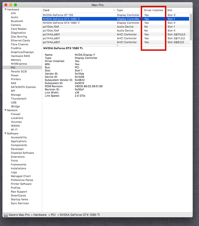

Go to System Information / PCI. Does it actually show the drivers Installed ?
There is a common issue installing the web driver the first time. A gatekeeper exception needs to be allowed in Security & Privacy. If this is not done the drivers will look like they are loaded but they are not Completely loaded.
Plus, if the driver installer fails to install the drivers it gives NO ERROR MESSAGE saying so. That makes you believe everything went fine when it did not.
If not fully loaded you will get symptoms like yours. The card is not identified properly. "NVIDIA Chip Model"
The fact you have the Nvidia Control Panel does not necessarily mean the drivers are installed.
I could be wrong but that's what I've seen before. Check in PCI and see what is says...
