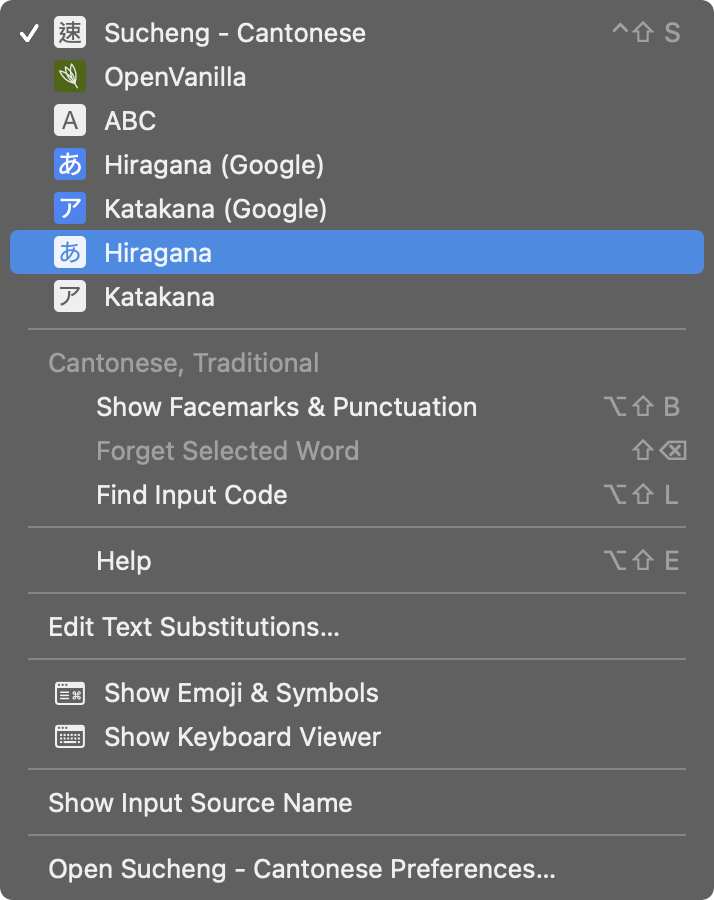

Step 1)
Add Japanese input - Romaji.
N.B. MUST be Romaji, but not Kana.​
Step 2)
Tick the box "Show Input menu in the menu bar"​
Step 3)
Select Hiragana from the menu bar
Step 4)
Type aeiou
If Japanese input works, you should see some Japanese characters during typing.
If fail (e.g. due to missing AVX), then you will only see aeiou, basically same as English input.

Mojave is fine.
It's Catalina and Big Sur has problem (Japanese input). But my steps above is specifically for Big Sur. I haven't try those steps in Catalina, not 100% sure what the result will be.

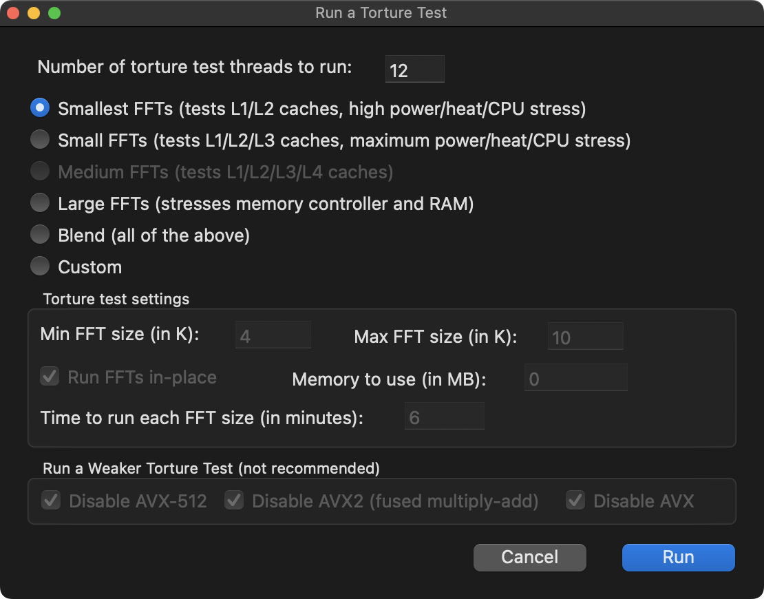

The latest Prime95 for macOS has AVX options, but it's grey out on my cMP.
I am not sure if that options will become avail if AVX emulation works.

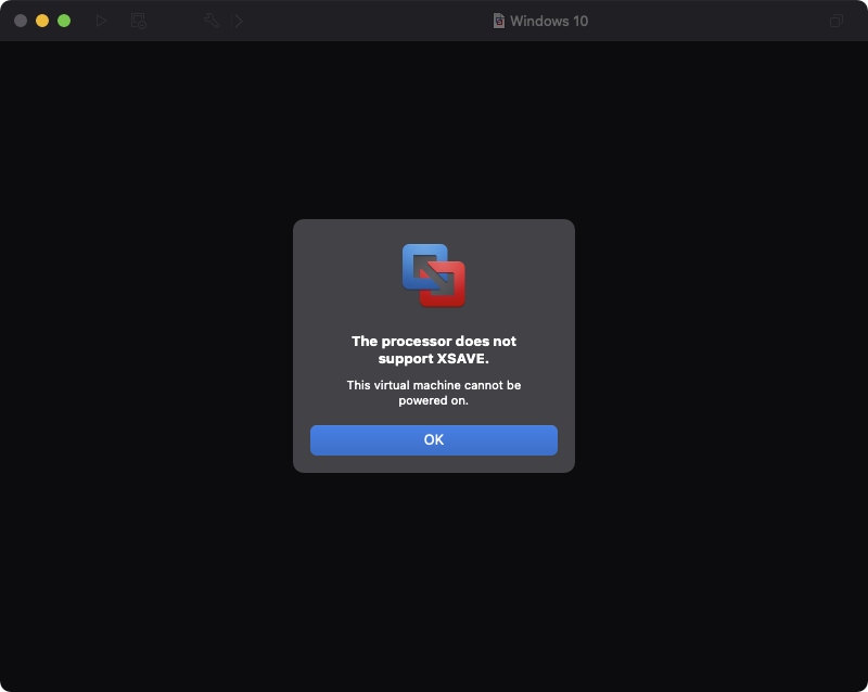

On a related note, is it possible to build support for the XSAVE processor extension? VMWare Fusion requires this extension for Fusion v12 and up. Also Fusion v12.2 and up require a minimum of Big Sur. So 5,1 users can no longer run the current version of Fusion. The "player" version is free: https://www.vmware.com/products/fusion/fusion-evaluation.html. It would be pretty awesome to be able to run Fusion on my 5,1 again. I know Parallels is faster (I was forced to switch) but I'd go back to Fusion for the more flexible licensing and the ability to easily (instantly) swap VMs with windows users.

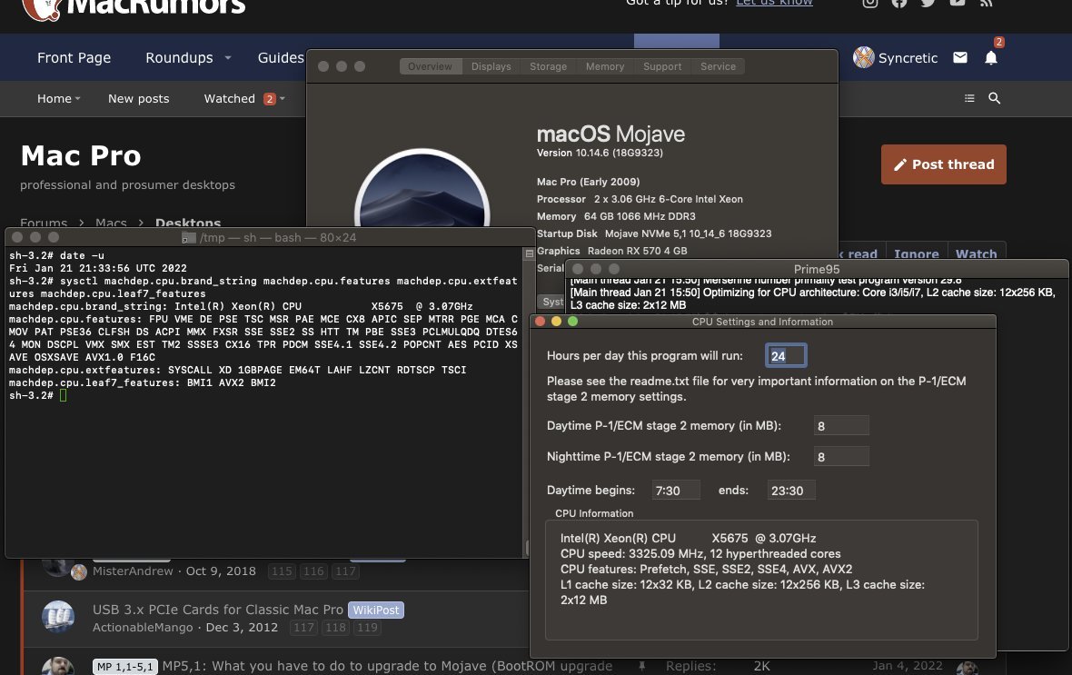

If you look closely at the machdep.cpu.features in the image I posted, you'll see both XSAVE and OSXSAVE shown. XSAVE/XRSTOR are actually a requirement to support AVX - without them, the YMM registers aren't preserved during context switches. Unfortunately, XSAVE/XRSTOR integration into MacOS is the trickiest/hardest part of the whole thing. (Oddly enough, Apple didn't have emulation in mind when they coded the kernel... ;-)
Sorry, the AVX emulation I'm working on only operates under MacOS. Windows and Linux aren't covered by this project.
Very exciting news! So if this project succeeds I've got a chance of being able to use VMware Fusion 12.x. I'll give this a try as soon as it's available.

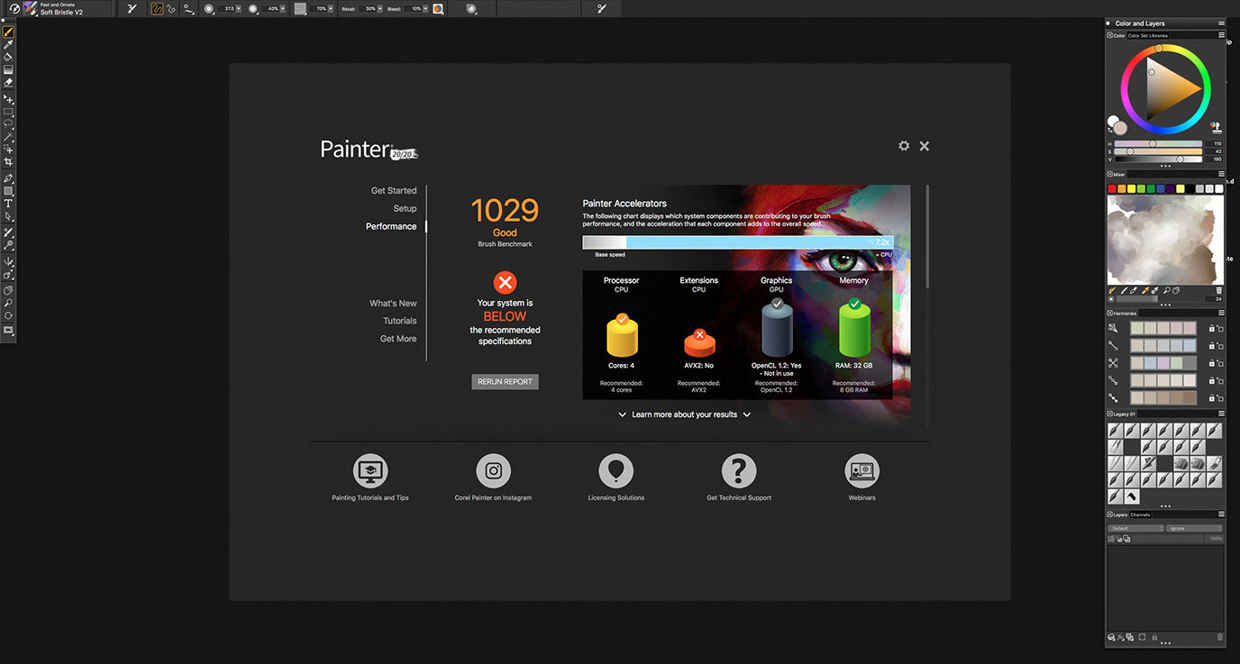

Corel painter 2020, 2021 and 2022 brushes works better with avX2 CPU. (accelerated on MacBook Pro i7 4850HQ vs Mac Pro 5.1 with better GPU, MacBook Pro Geforce GPU not Working with Painter 2020 + 😭).
Painter use a performance test (Corel Painter/preferences) who detect Avx2.
The lazy Programmers, instead of Escape motion competitor, do not code it anymore for SSE4 + Avx2.
Is there any chance to run Corel Painter better on Macpro with the emulator ?
