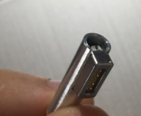

I milled off the enclosure of the defect Magsafe-L and made my own enclosure which is open on the connector side so it's easy to repair the cable once the cable is worn out (or it would even be possible to add a better cable relief), I closed it with a small cap (glued it in place and in case the cable is worn out again I can just open it again).

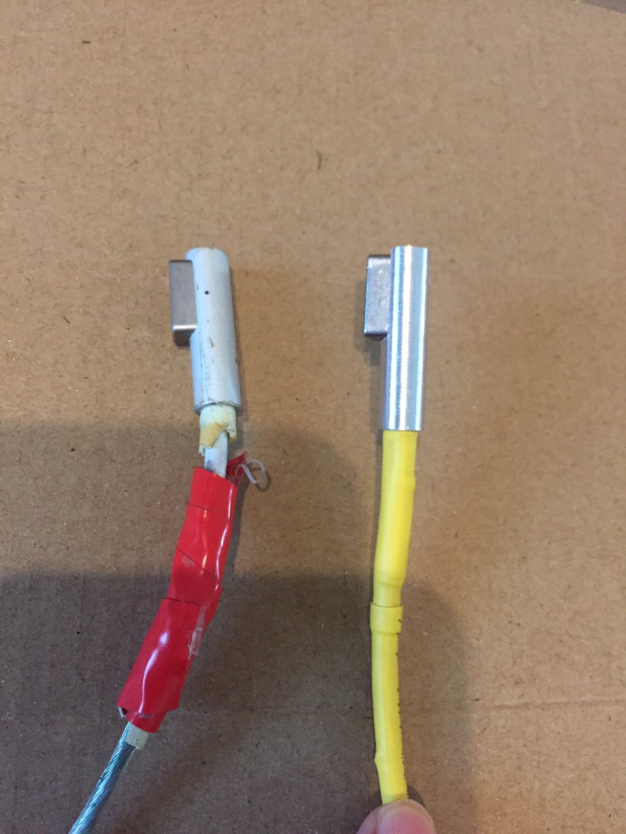

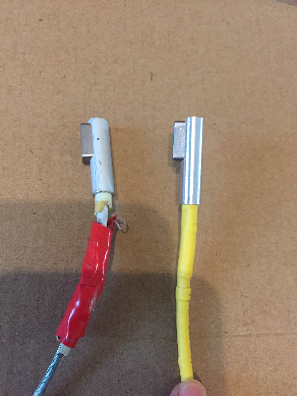

I'll get some other heatshrinks for the second one and will also drill a small hole into it to expose the LED.
Left the original one ... right the reworked one.
First version (The nob will be gone with another one):
the small hat is glued but can be removed, so no need to use pliers to damage the connector in case of another service (which I expect since I'm still using the bad quality cable, but I'm sourcing better ones now).

The cable with the red tape has a terrible isolation, just the same as in the other discussion:
Machining maintainable enclosures at least allows to use alternative cables and change them whenever necessary, and I don't have to buy the entire replacement cables anymore because they are even worse than the original and require regular swaps.

I still have to rework the cable with the red tape; I'll make some photos when I work on it. Possibly this weekend.

I'm just sliding in the connector into the blank which I have made before and put the cap on with super glue as mentioned.
I'm not glueing the entire connector it's just stuck firmly enough in the thin slot - it's re-usable 🙂
