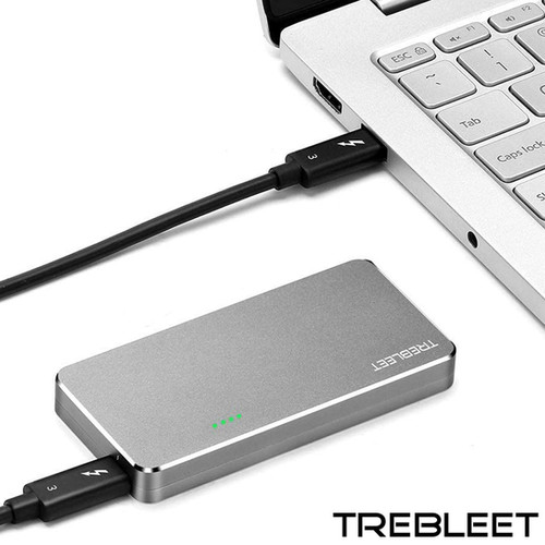

But, in real life, the speed is lower, like 2800 mb/s for this enclosure:
[URL='https://www.trebleet.com/product-page/trebleet-thunderbolt-3-to-nvme-m-2-2280-hard-drive-case-ssd-enclosure']Buy Thunderbolt 3 NVMe M2 External SSD Enclosure with Free Shipping
[/URL]

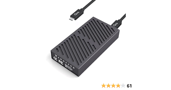

Or 3100Mb/s for this one
41RGkyMWGKL._SR600,315_PIWhiteStrip,BottomLeft,0,35_PIStarRatingFOUR,BottomLeft,360,-6_SR600,315_ZA61,445,290,400,400,AmazonEmberBold,12,4,0,0,5_SCLZZZZZZZ_FMpng_BG255,255,255.jpg
[URL='https://www.amazon.ca/KONYEAD-Enclosure-Compatible-Thunderbolt-USB/dp/B0BB5W3QGQ?th=1']KONYEAD 40Gbps NVMe Enclosure, Compatible with M1 Pro/Max/M2 Mac,Support 8TB M.2 SSD,Compatible Thunderbolt 4/3 USB4.0/USB3.2/3.1/3.0/USB C Aluminum NVMe Adapter(8117)
[/URL]

The Trebleet enclosure has a more honest assessment of its performance - and their web page lists all the incompatibility problems.
The Konyead enclosure is a mashup of TB3 + USB 3.2 controllers - like the Orico enclosure that is mentioned in earlier posts, that had problems in use with a Mac.
