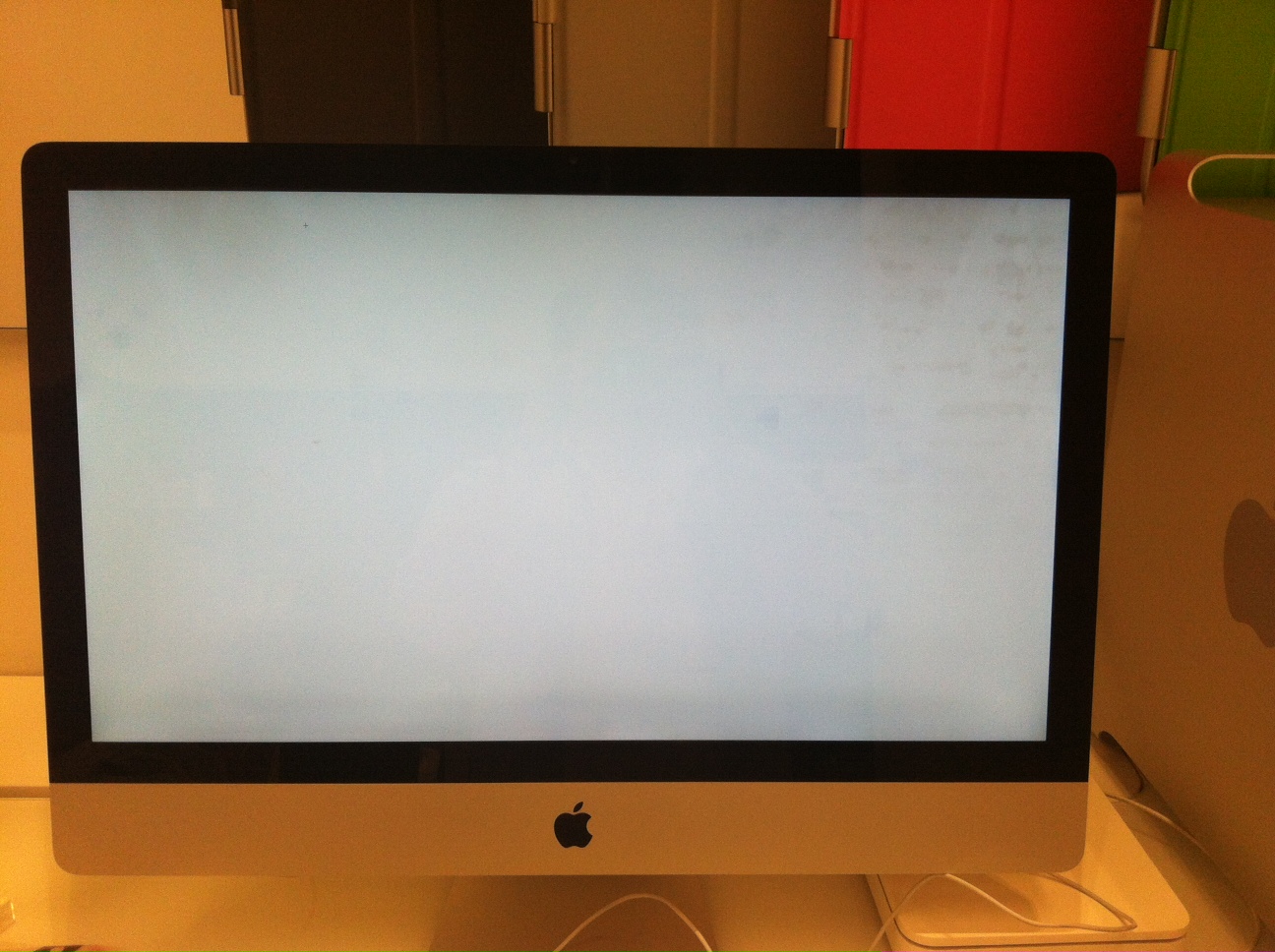

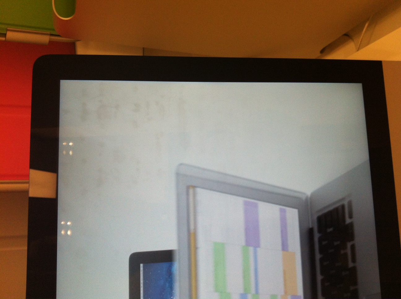

Also, I don't know if this is true or not but a number of salespeople from various apple istores have told me that the brown/gray marks that appear at the top right of an iMac screen are caused by the machines running at high temperatures 24hours a day, all year long. Before i bought my iMac, i visited 4 different istores and all of their 27-inch imacs had horrible brown areas at the top right and lesser marks at the top left. Do you know if this is caused by heat or dust?
I'd have to see the screens to know for sure what you're referring to. It's very unlikely it's a heat issue. Macs are designed to manage temps to keep them in a safe range for many years. Most iMac users never have such issues, or the forums would be filled with complaints about it and a recall would be likely.

Please have a look at the attached images. They are of iMacs at the iStore. I don't know if you'll be able to identify the problem but if you can it would help - I'd like to avoid this happening to mine. Also, I forgot to mention that the computer lab at my university makes use of only 24inch iMacs and all of them have these brown/gray marks at the top of the screens.
It appears such screens are defective and the marks may relate to humidity. I would make sure it's covered by AppleCare in case that happens, as Apple has been replacing such screens that are covered by warranty/AppleCare.
iMac 27″ screen displays dark stains, spots and patches « The Nanchatte Technojunkie
Well my one year warranty is about to expire so I better extend it ASAP. I really didn't want to buy a warranty extension.........
