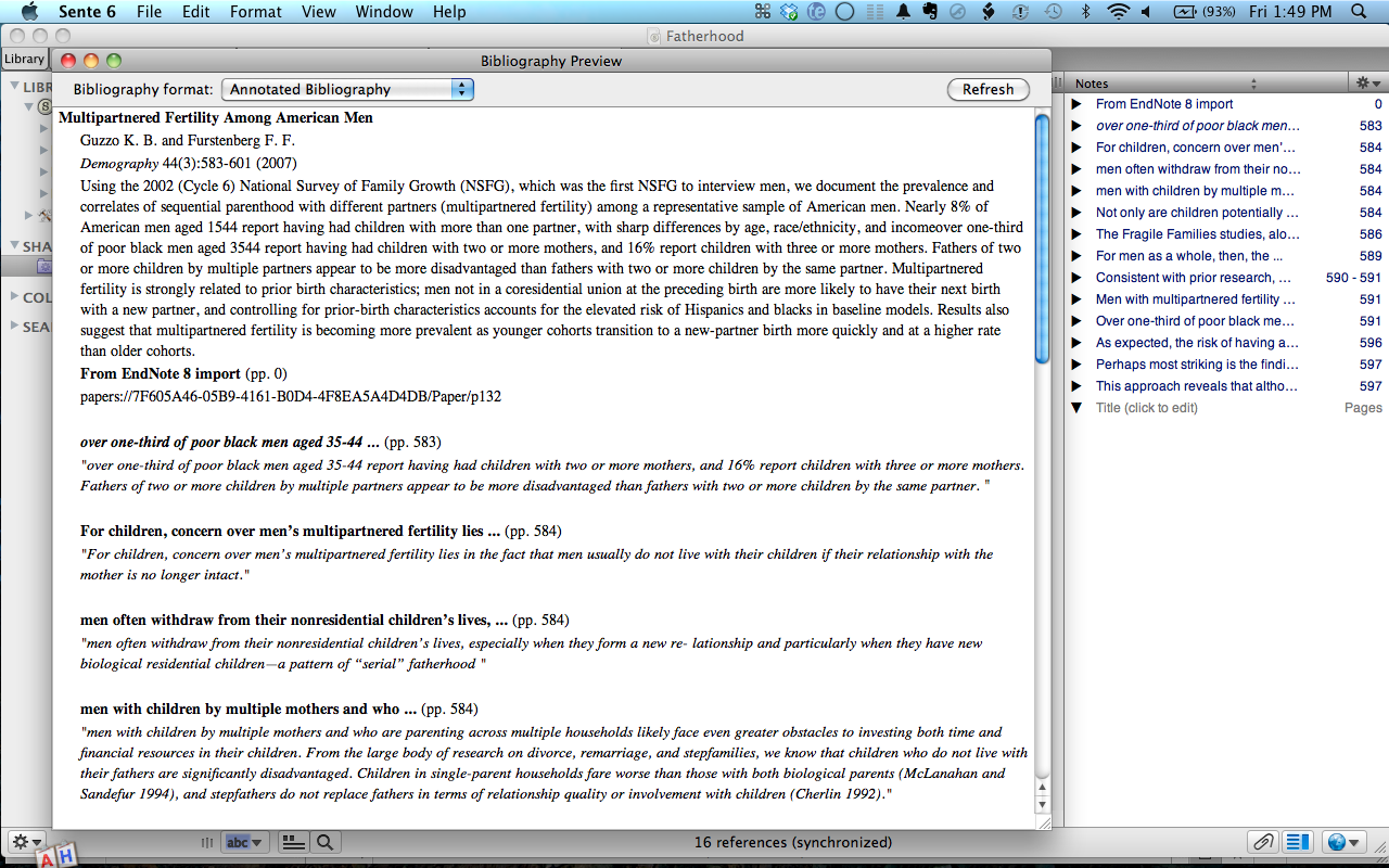

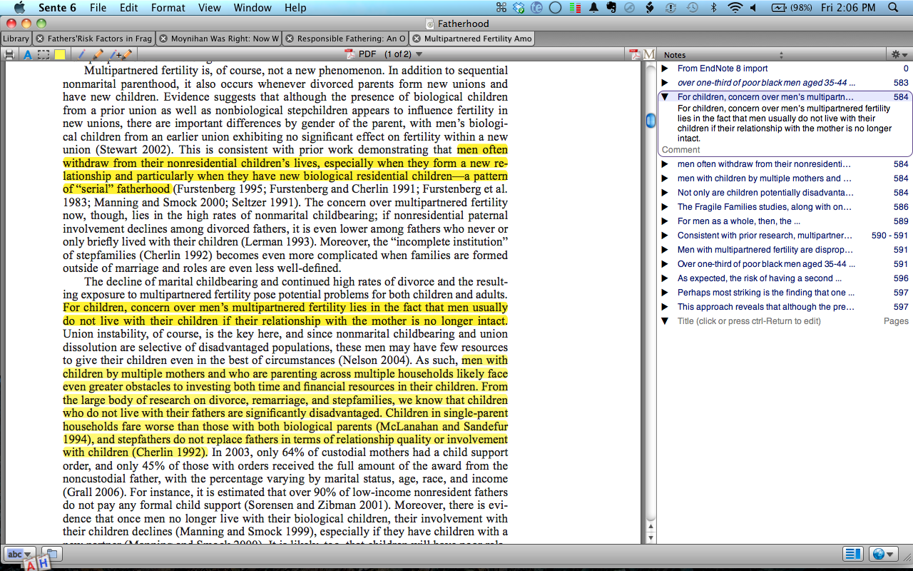

Some time has passed since the last post, but have you tried Sente? You can highlight PDF's, take notes, take snapshots of graphs, extract direct quotes and attach your notes to them, etc. In the end, you can Preview "Annotated bibliography" and voila, all notes from the document, direct quotes, snapshots, quotes with notes attached, etc appear in one document with all the reference information at the top.
In my workflow I paste the annotated bibliography I do in Sente for each article into Scrivener's research section, so I can keep all the direct quotes, graphs, quotes with notes attached, etc. that I'm going to use in my paper after a very necessary first "filtering" process (Sente separates each note/snapshot/highlight with a title and the page in the original document where it came from, a beautiful feature, I think). I simply copy and pasta the APA reference info that comes with the annotated bib for the article into the title of the Scrivener research document in question, so it stays organized within the research section also.

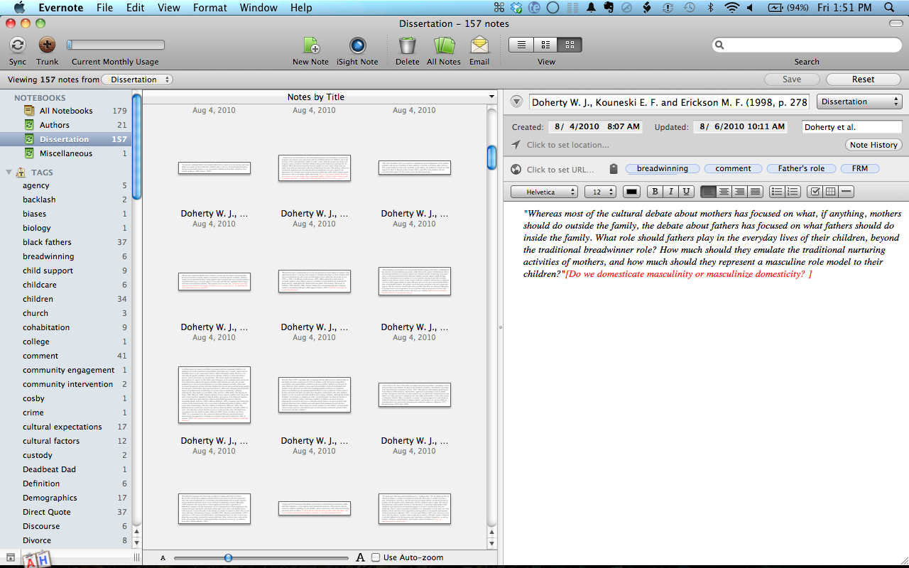

Because I like to be able to search each individual snippet of text according to tags, I use keyboard shortcuts to highlight and import each individual snippet that I'm using as a direct quote from Scrivener into Evernote. Because the title of the document in Scrivener is the APA reference info itself, each note copied into Evernote carries that title, and therefore the reference info itself without me having to type anything into it. All I do is add at the end the page number Sente so kindly provided for organization purposes, and then tag the hell out of it. Once you know the keyboard shortcuts is a rather quick process.
When I want the direct quotes related to (say) "fishing," "tuna" and "global warming" while I write in Scrivener a particular section, I select those tags in Evernote and voila...all the snippets from 170+ articles tagged with those terms appear. If I want to go back to the source of one of those I look at the reference and consult it and my longer notes in Scrivener, since I am writing right there. In the rare occasion in which that is not enough to clarify something I may go back to the source in Sente and re-read, but that is rare.

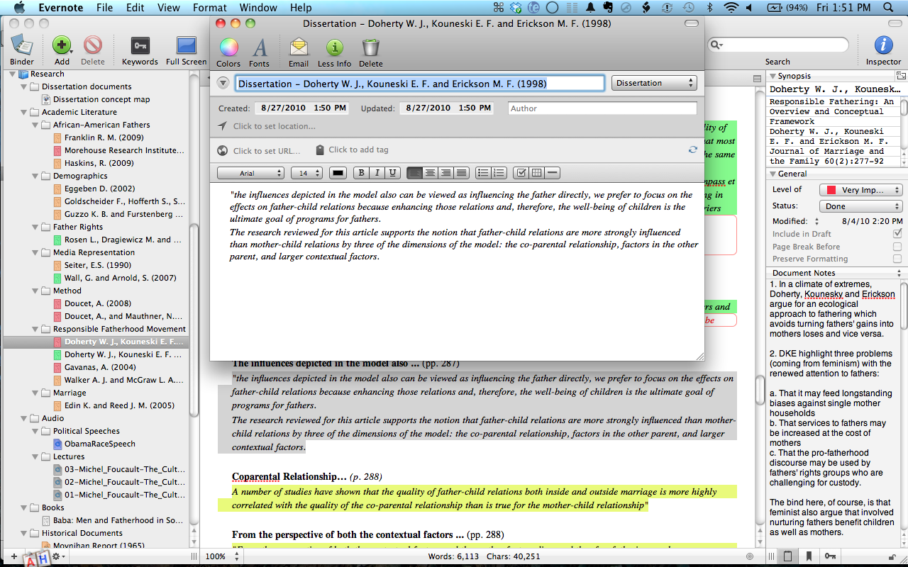

You can simply add the section of your paper BEFORE the reference title on evernote, or simply (the better option I think) add it as a keyword (you search for "Introduction" would show all notes with that "keyword." Attached are my snapshots of the process...hope it helps!

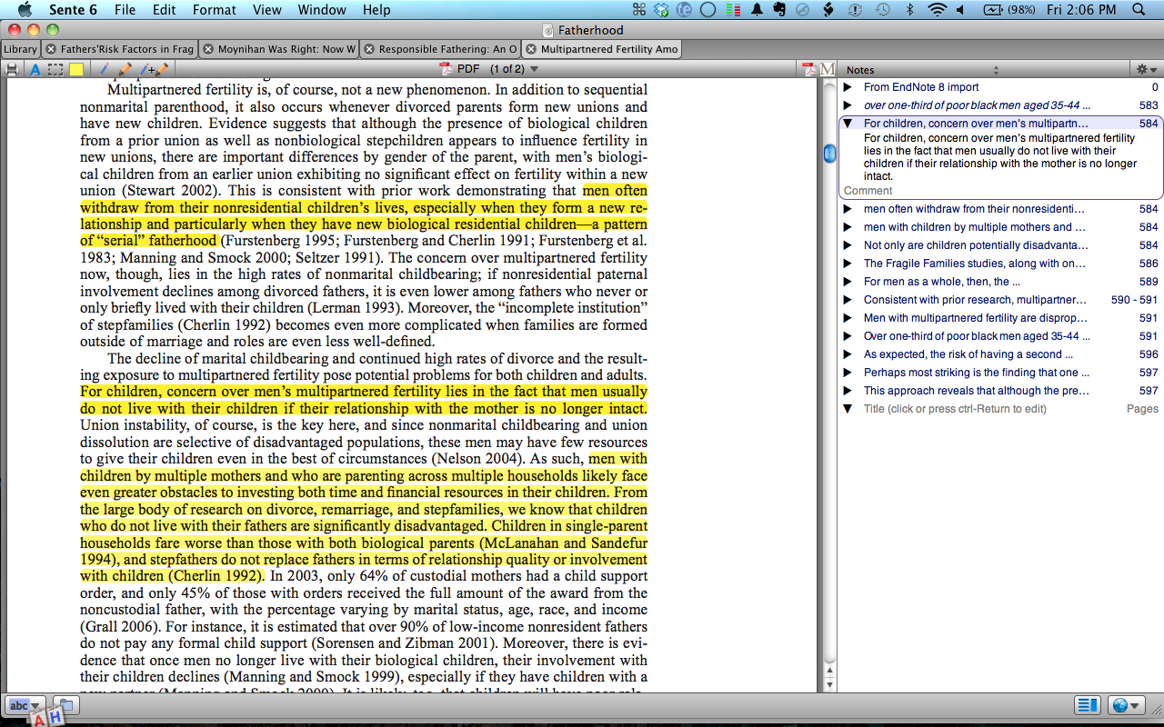

Here you see Sente with a reference open as PDF, Highlighted and some of those highlights as notes on the sidebar...No comments below them here, although you can do that if you want to

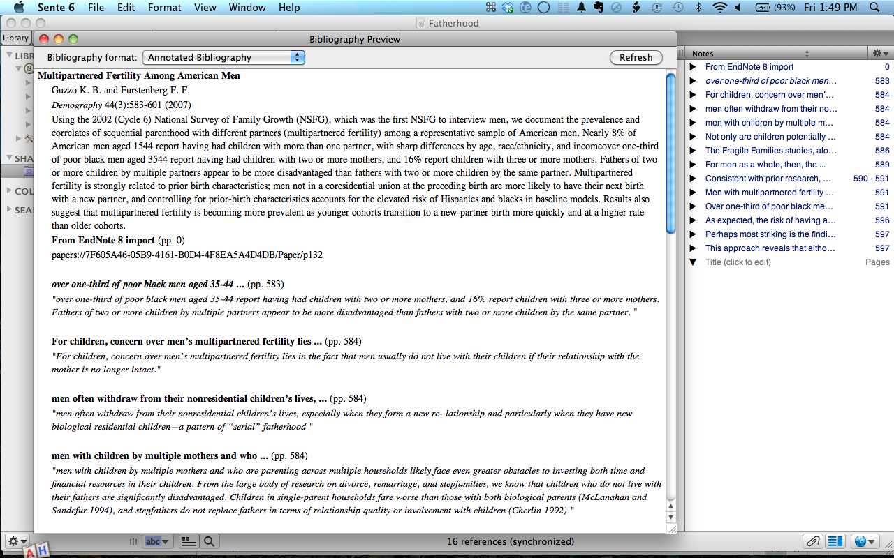

Here you see the "annotated bib" window of Sente, with reference info and page # for each quote. You select all and copy to add to scrivener.

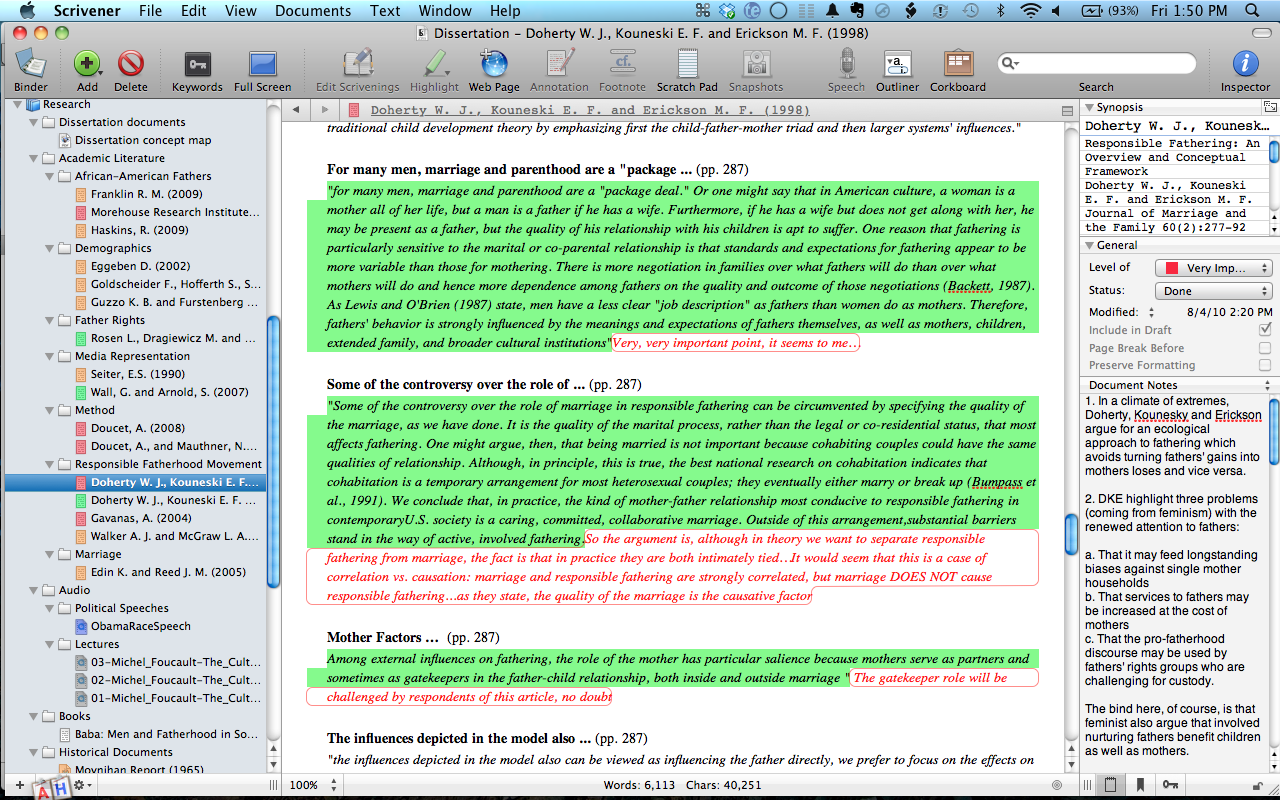

Here you see the scrivener page, with annotated reference added under reference section (title on top) and my second reading, highlighting, notes, etc. for specific project.

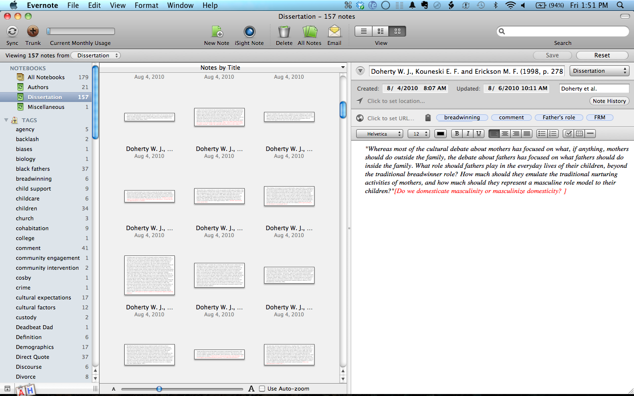

Here you see the clipping window from evernote on top of scrivener. I select the quote on scrivener, control-c to "copy," control-command-v to clip to evernote. It appears with "Dissertation (the project in scrivener in front of the reference). I delete that, add the page number at the end and add my keywords (easily, as evernote autocompletes according to what you already have...if they are new, you'll have to type the whole thing, obviously)

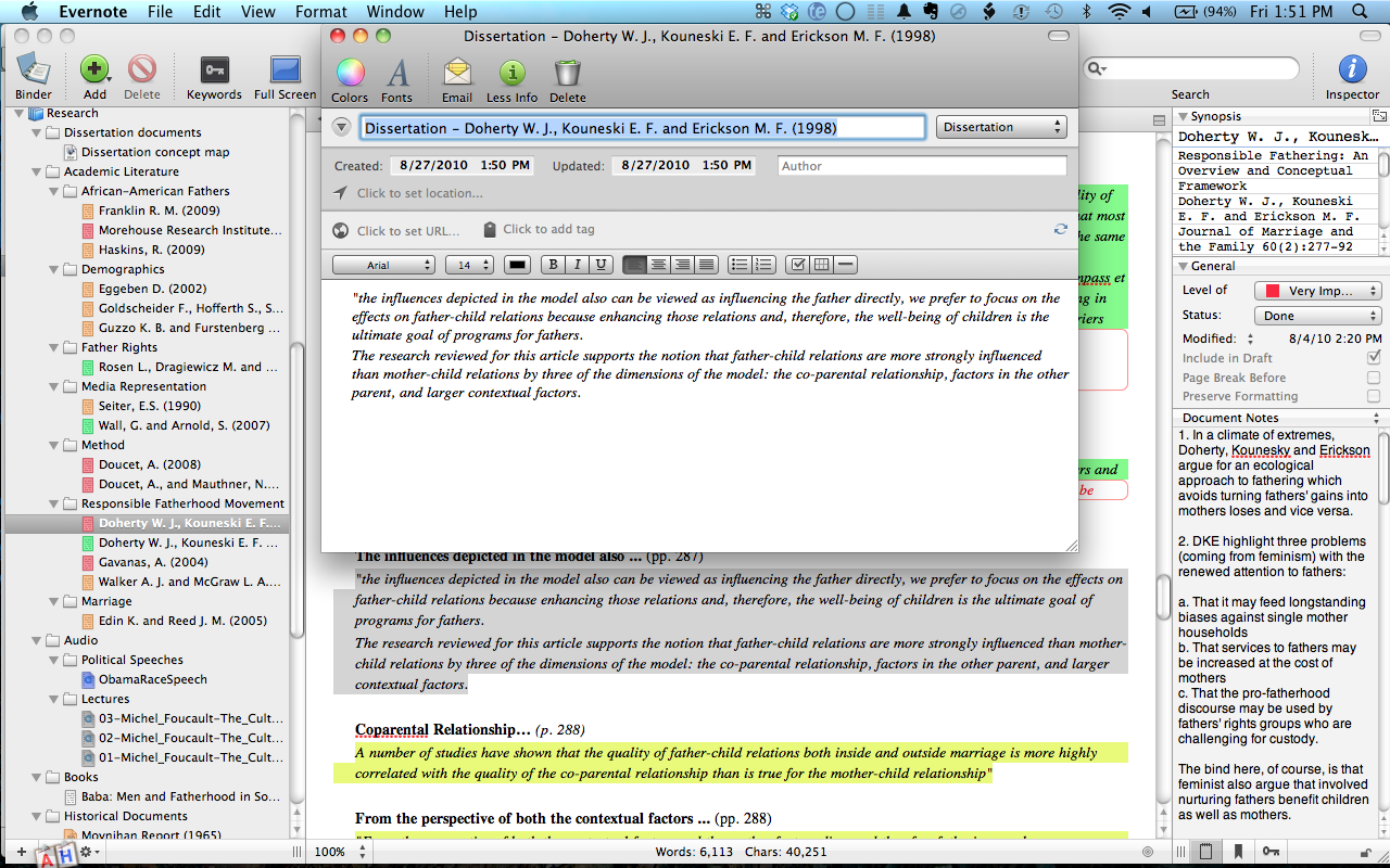

Last one...Evernote with various snippets from scrivener. You'll see the list of keywords on the side so. Additionally evernote searches ALL text if you want it too.
