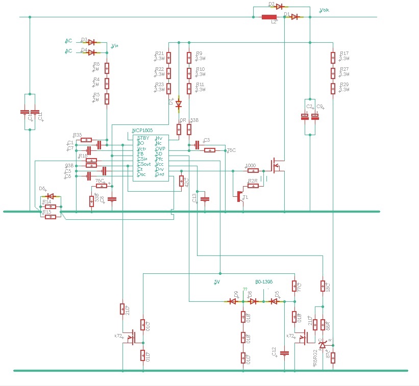

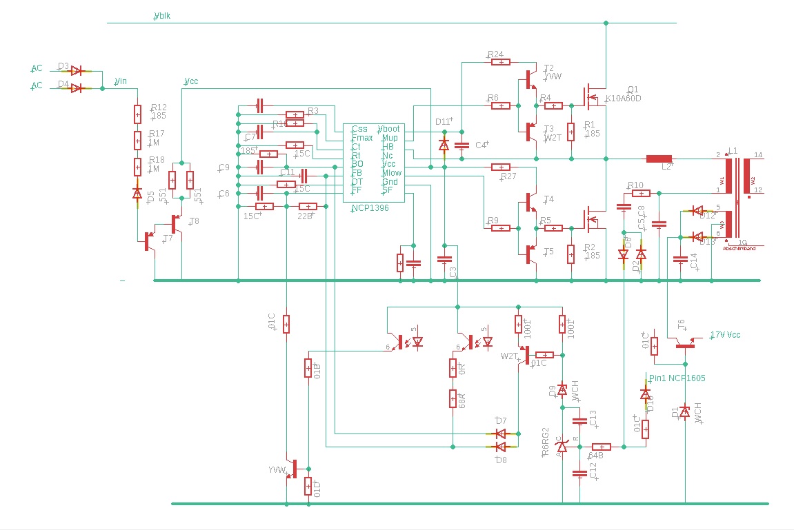

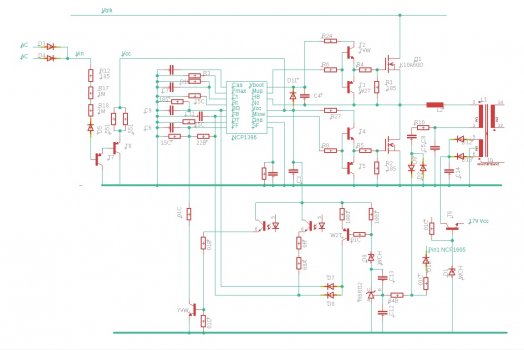

A functional test of the PFC stage with NCP1605 can be performed this way:
1. verify there is no short circuit by mosfets and diodes
2. unsolder the two mosfets driven by NPC1396 (they might be defective)
3. There are four hight impedance resistor chains build with 2 Mohm and 3.3 Mohm resistors
4. solder a wire bridge across two of the three resistors
5. The PFC circuit then accepts 90 Vac /3 = 30 Vac and generates Vbulk = 385 Vdc /3 = 128 Vdc
6. connect a transformer (230 Vac => 48Vac) to the input (galvanic isolation for using a scope)
7. connet a 230V 25W bulb to Vbkl to have a small load
8. insert two 12V /10W bulbs in series in the 48V AC supply cable
9. Supply NCP1605 with 17 Vdc against primary gnd via a 100 Ohm resistor
10. Switch on the transformer and the 17V Vdc source.
When measuring Vbulk = 128 Vdc and Pin13 = 5V the PFC stage is 99% Ok. If not, check the voltage at each Pin of NCP1605 using a voltmeter or a scope. When disconnecting the 17 Vdc you'll see a fluctuating Vcc. NCP1605 is charging the Vcc capacitor via pin 9 HV and starts up then. Without getting the aux. voltage from the LLC stage transformer, Vcc collapses again.
The following defective components could be identified at my PSU: short circuit of both mosfets driven by NCP1396 and the 1000V diode 1N5408 too. High impedance of a 10 Ohm gate resistor (low side mosfet).
73
to be continued with NCP1396 and the LLC stage functional test.

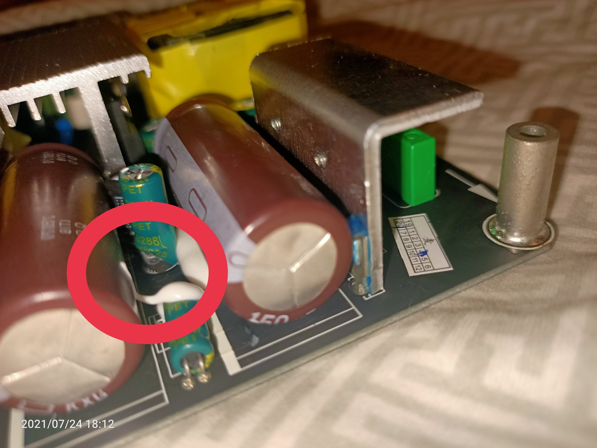

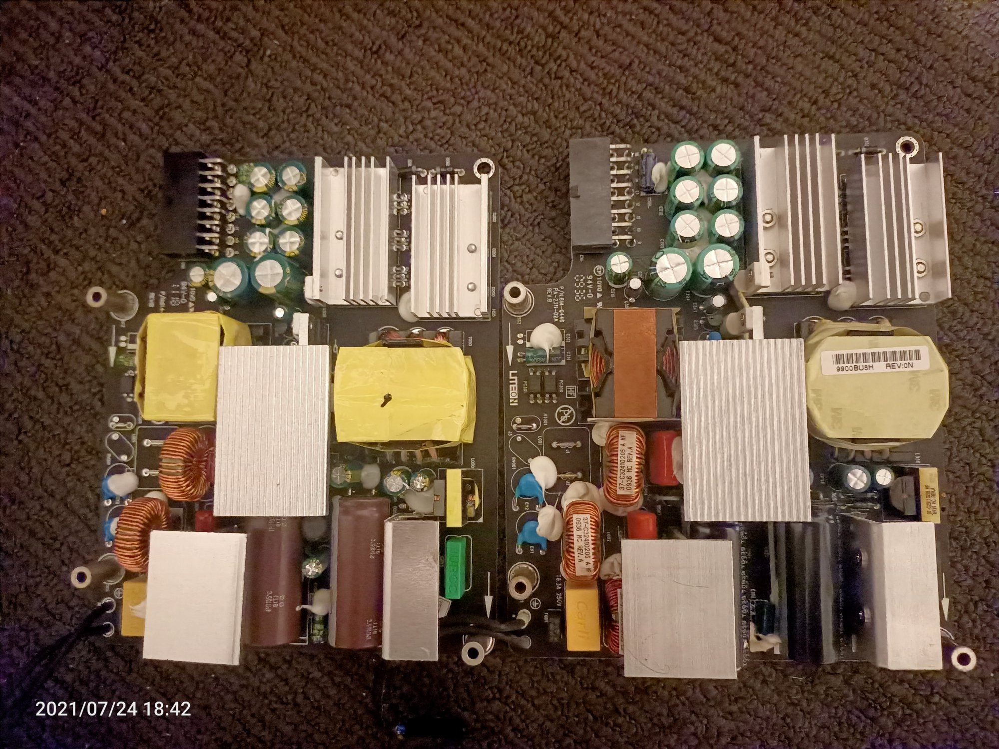

I bought an apprently new genuine 310w PSU after installation there was a little crackle and pop, I cannot see any blown components on the PCB and after removing the power cord and reinserting it I get power on.
But here's the catch I think it blew the temp sensor as the CPU fan runs full speed and iStats menu reports power board proximity at 103' c or after a reboot no value at all.
Power heatsinks report normal values.
The seller agreed to refund and said I can keep the board.
Does anyone in this thread know the component I need to test or inspect for damage?
Cheers.
EDIT:
Upon closer inspection I found this 😳
Crazy that this PSU still powers up.
Interestingly the original PSU on the right doesn't have the cap and the component behind it?

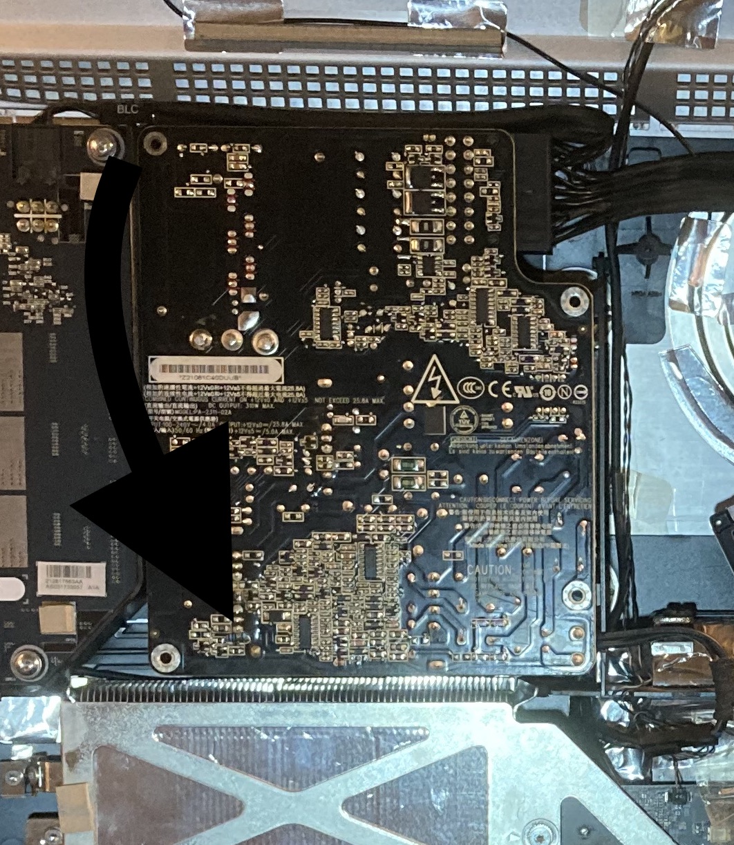

Hi, not sure to break some rule about necroposting my issue here, but since it looks like a lot of people are competent I will give it a try:
I have an iMac 27” 2011, suddenly it stopped working, the diagnostic led 1 is on but it turns off as soon as I press the power button..
I checked the PSU and 12v looks fine, 12v (pin 5) standby is present and if I short the PS-ON with ground I get 12v on pin 11->15, which I tested under load with 15A and it works without problems..but, I don’t get any reading from pin 7-10 (SMB_ACDC_SCL_RC and SMB_ACDC_SDA_RC, which I understand should be some data pins to the mobo, maybe?)..now, if I check where these pins go, they converge to some kind of dual diode (like a bat54, or similar) and on the other side of that “diode”, the common anode (or cathode?) the signal is short to ground..is it meant to be like this? May the problem be on the motherboard side?
Your power supply is working, as you are getting 12V.
The failure pattern you experience is very typical for the mid 2011. It is the graphic card.
Take out the Mobo, and then take out the GPU. Bake it. Read up on "bake GPU imac 2011". I do4 to 5 minutes only. Last time, I covered the entire PCB with aluminum foil and only cut out the area on top for the graphic chip. Also worked. I found the capacitors are quite stressed from prolonged baking, that's why I keep it short.
Then reassembly. Don't forget new heat conductive paste.

Thanks for your exhaustive reply!
I had already excluded solution n.1, trying a different outlet, and checking the standby voltage on the psu installed, and it was fine.
The gpu was working fine when I first installed it, I put some tape behind the heatsink bracket as well, but I will try the taping solution just to make sure..the thing is, I have tried to turn the iMac on without any gpu and it behaves exactly the same way..
Here’s is the area where I found the short, on the top side of the diode pointed by the arrow, the other two ends are going to the molex connector data (?) lines..

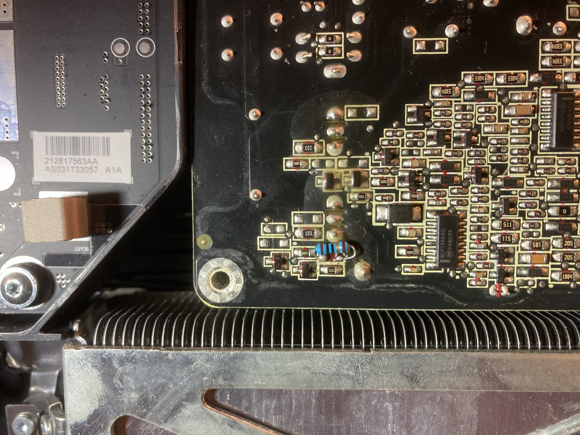

My mid 2011 27 imac would not start one day, psu is "pa-2311-02a"
No power whatsoever on connector to mainboard, no light on diagnostic leds.
Looks completely dead.
Fluctuating voltage in secondary circuit (7-14V) as some others here have said.
Tested various smd components, found one 10 OHM resistor way out of spec. Replaced with standard through hole resistor, as it was the only thing I had at hand.
Images attached.
Powered up straight away.
Happy days.
Hope it can help somebody.

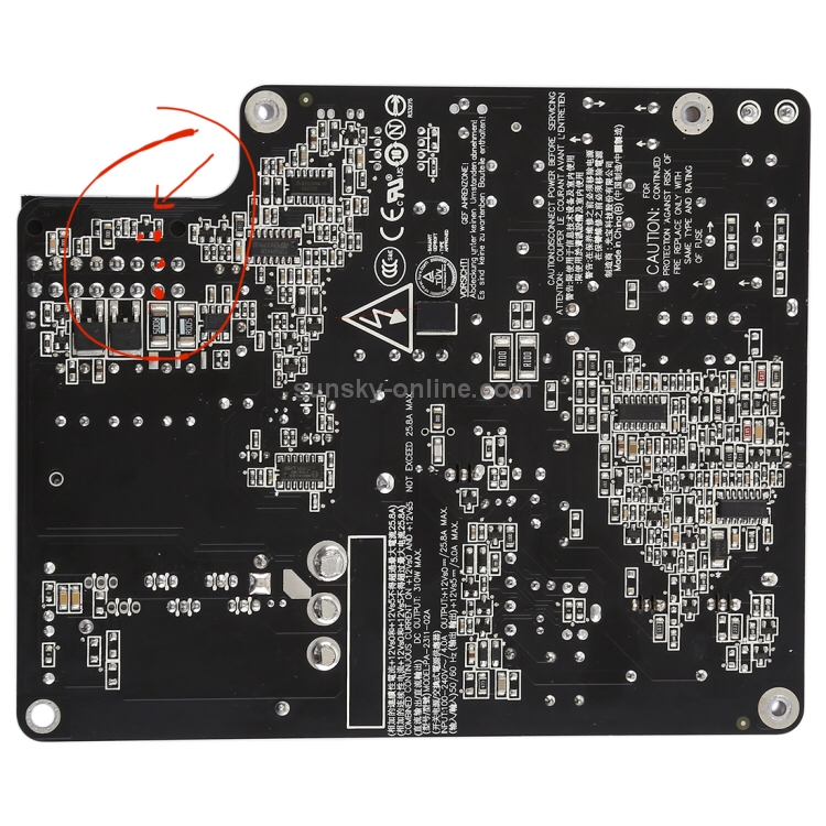

Here are the notes that I took for myself, with designations of some critical parts.....
