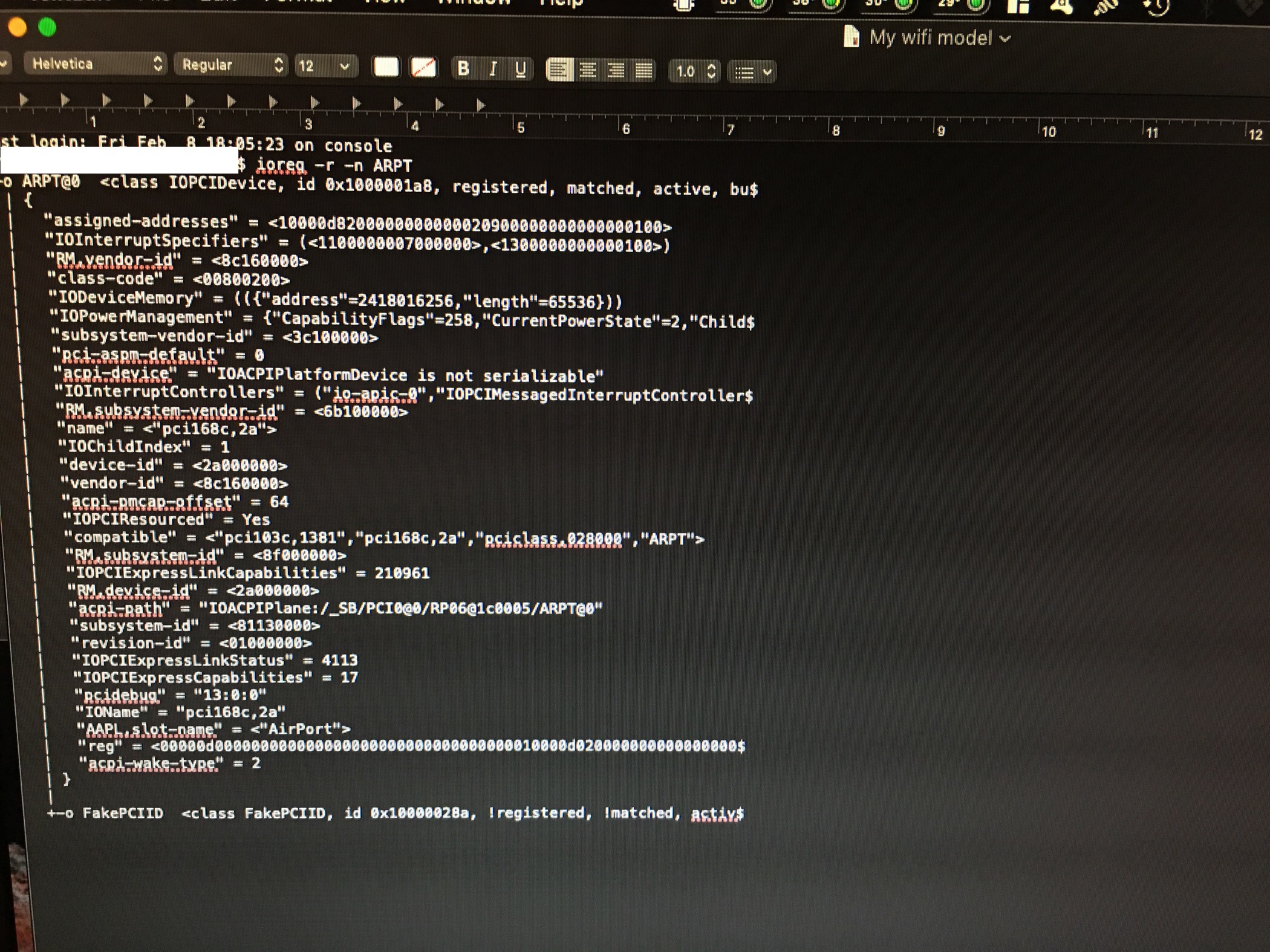

Hello I tried searching for my issue and for what I found seemed as if it could fix my issue with my WiFi Card not showing to be selected in the network setting in System Preference under Mojave. How can I fix this if the instructions to do so is different?
I’ve read from many forms regarding my WiFi Card type and it’s said to be a Mojave supported WiFi Card. Before I shell out money to purchase a replacement WiFi card for my 4.1 flashed to 5,1. I wanted to provide some details I have that’s different.
My Mac Pro WiFi Card has worked fine with Continuity and all of its features plus AirDrop while it ran High Sierra. I checked to see if my WiFi Card was supported for Mojave before performing the install. After install the card icon had a ‘x’ shown.
I checked Network Setting in System Preference and the WiFi was on the list but it would not start. WiFi is show in About this Mac. But it’s only showing information that’s not at all the same as it had shown in other Mac OS prior to Mojave.
Everything I’ve found regarding pci168c,2a which I’ve found using Terminal command: ioreq -r -n ARPT (See Copied Text image Attached). Instructions to edit the Kext in the of AirportAtheros40.kext found in IO8211Family.kext list.
AirportAtheros40.kext wasn’t one of the listed Kext found in the plist under IO8211Family.kext. So is there a way to download AirportAtheros.text to have it added to IO8211Family.kext plist? Or does this mean the information about my card is wrong?

I’m not going into handhold mode with a lot of detail, but I think your card is a non-starter in Mojave PERIOD!
For $10-$20 bucks, you can get a compatible WiFi card on eBay, if you are just looking for normal WiFi compatibility. If you want the Full-Monty (WiFi A/C, with LEBT & Adapter/Antenna as a PnP kit) then you will pay more. The pay more option gets You Continuity / Handoff / Air Drop 2 / Apple Watch Unlock.
You are getting no where with your current card and aren’t likely to find a solution with it while on Mojave.
Answers have been given, options have been presented. The solution is to just replace it and move on.
Good luck...

I’ve found software written to add AirportAtheros40.kext back to Mojave since Apple felt the need to eradicate it.
I can’t name the site that has this available. But a simple Google search for airportatheros40kext installer for macOS Mojave should take you right there for those looking to save money. And no it’s not a torrent thank goodness.
I agree that paying $10-$20 is cheap for a 3rd party replacement. But given the price I paid at the time for Apple’s expensive Airport Express Card years back just doesn’t sit well with me. Especially when it provided all the same functions you listed. Minus one with the Apple Watch since it’s not a thing I own and it never crossed my mind to validate it’s ability.

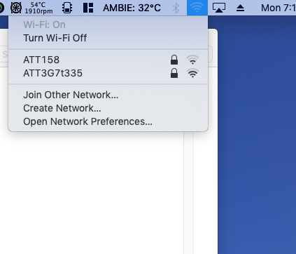

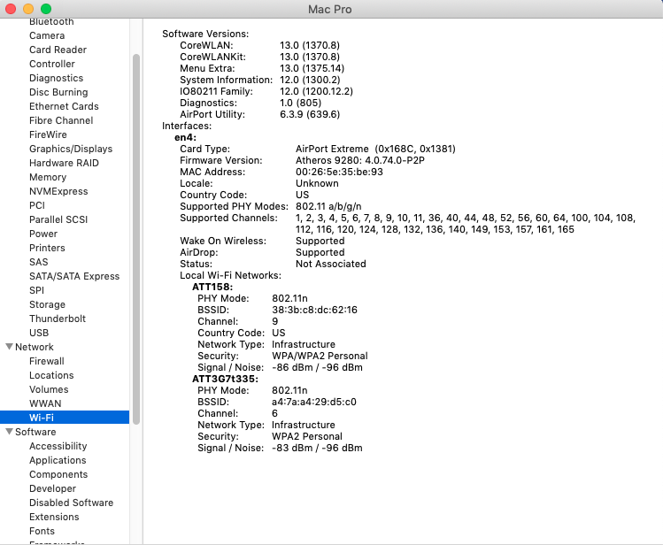

**UPDATE**
It’s working!!
Here are the screen shots:
