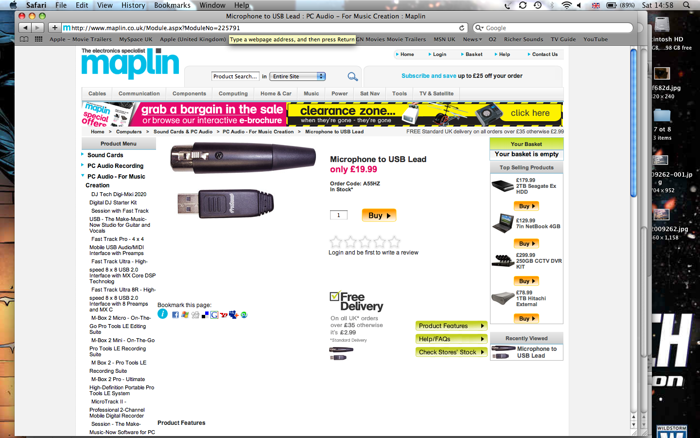

here is something found at Maplins in the Uk but you should find it anywhere. I recently bought one and after changing some settings on Logic Express, it works fine. Take heed to the previous post and have fun.

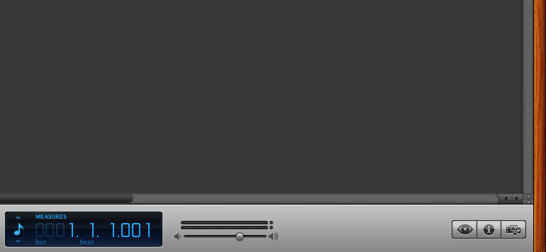

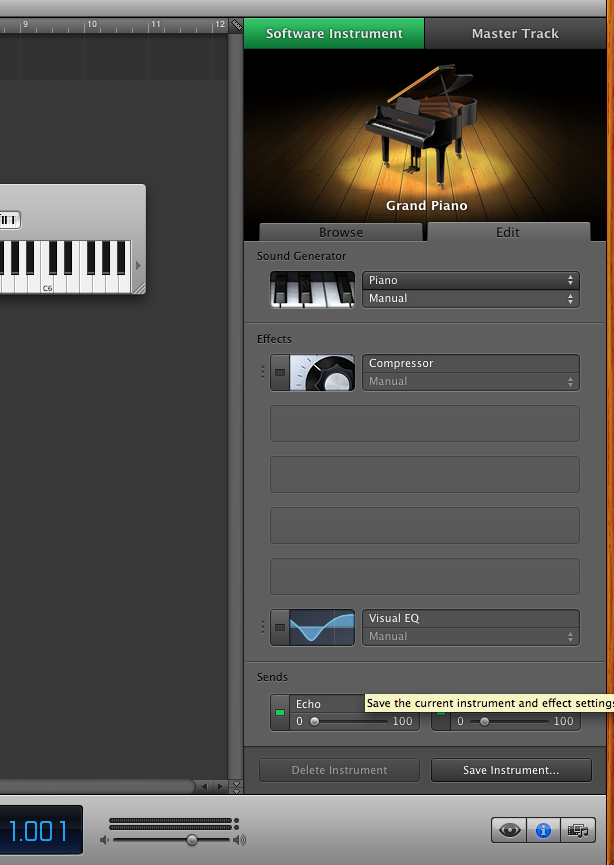

To add eq or any effects you can click the " I " button in the bottom right hand corner which will open the editing pane. then just click on the eq.
See the pictures below if your unsure.
