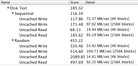

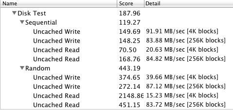

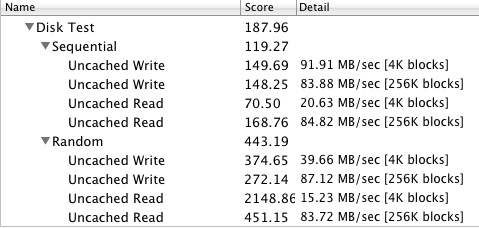

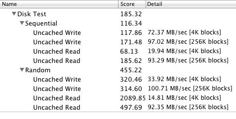

I just recently installed a Sonnet card and xBench test results over the ide/sata bridge card I was using would indicate that cost wise it was a waste of money. ($79 vs $3) but what the hey that's what hobbies are all about. SATA card first (left) then IDE/SATA bridge card.
These results are using an SSD, the card might fare better with a platter drive.
