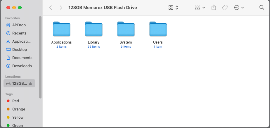

Now, here's another interesting discovery... I bought a USB 3.1 128GB thumb drive (Memorex; from Target) and a 3.0 Hub. And tried installing Big Sur 11.1 to it... and guess what... it worked! Kinda. 😁
It behaved a lot different than with the USB-C drive. And, as the picture attests, it installed more to the folders. But... when all was said and done, it seemed to get into a "boot loop" (white Apple logo and progress bar), where it would go so far and then restart and do it all over again. I'm assuming it shouldn't do this "progress thing" more than once, correct? 🤔
My USB-C SSD drive also has a USB-A adapter... I wonder if that would make it work?!? It would be a faster/larger device attached to the USB-A port, which seems to have worked better (even if not completely). Any thoughts?
Needless to say, after the "boot loop" scenario, my M1 Mac Mini seemed to have difficulty getting out of that mode, even with the USB drive removed. I go in and "First Aid" all the drives on the internal SSD, to make sure everything is ok, then resorted to specifically selecting "Macintosh HD" as the Startup Disk. That seems to work... weird.

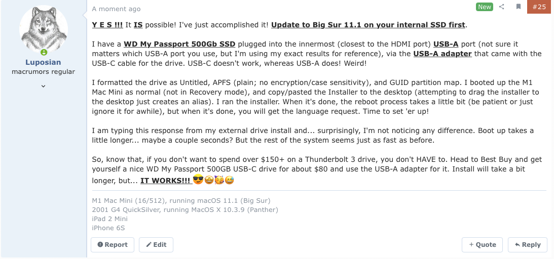

I will let the pic of my post on another thread be the culmination (conclusion) of this thread! AUSA!!!
Reactions: Quackers
Dreams do come true. Haha.
I think your persistence will help people looking at doing this. Well done.
Yeah, as long as they have an M1 Mac Mini with USB-A ports... I never got my drive to work with USB-C. And I haven’t tried it with my 128Gb USB thumb drive. The thumb drive attempt failed... possibly because of having it connected via a passive USB 3.0 hub and not directly to the USB-A ports on the M1 Mac Mini.
