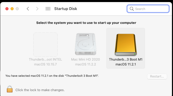

I installed 11.2.1 on my external Thunderbolt 3 M.2 disk but when I choose it it always starts up on the internal disk.
