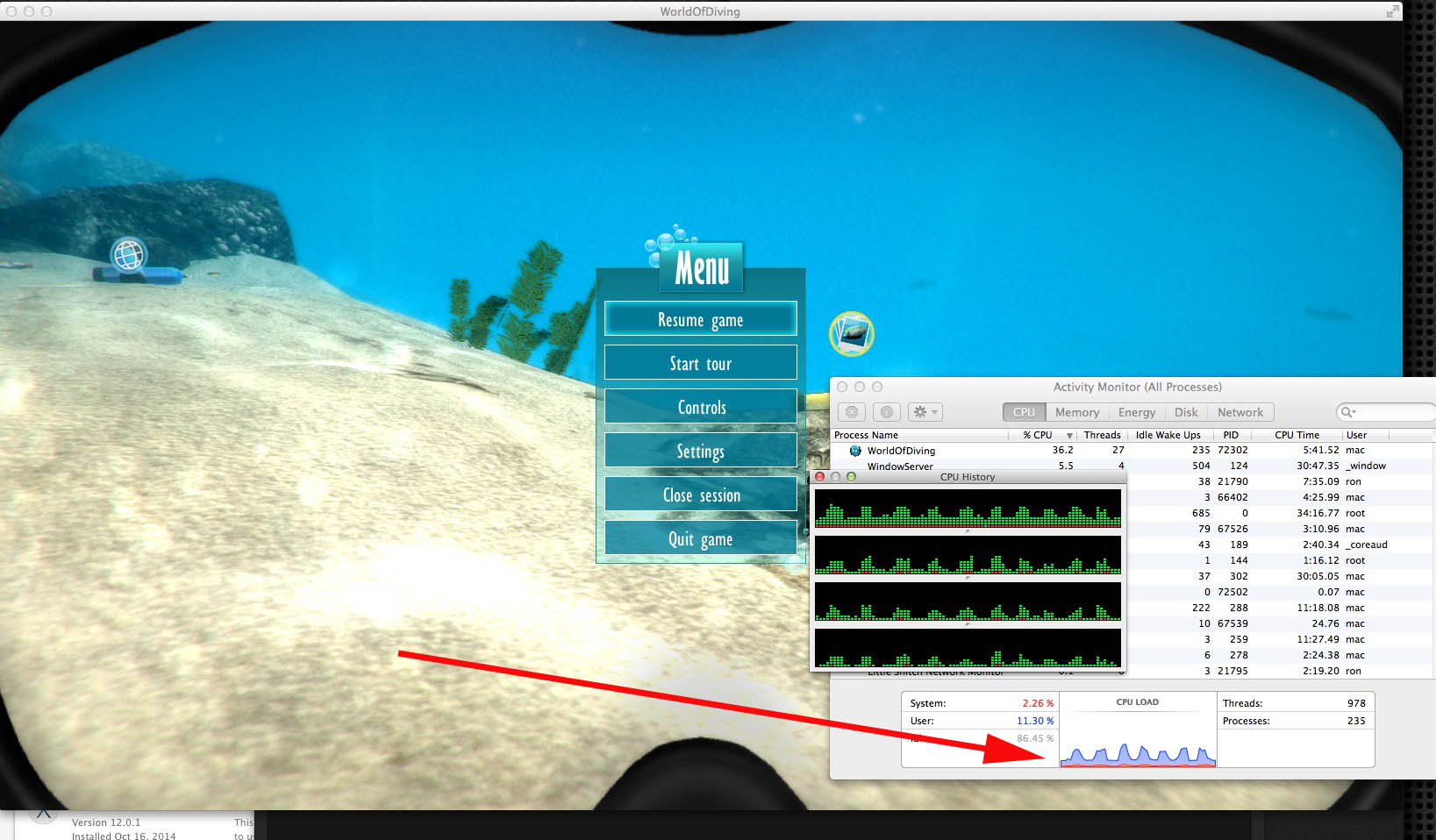

Recently I noticed a STRANGE (as in not related to graphics intensive issues) games running FAST (50 - 60fps) for 6 seconds. But then stutter down to about 12FpS for 2-3 seconds. This is a loop - which has nothing to do with what the game is doing. It will do it in a 3D game menu for example. Or not moving in a 3D game and just looking at the floor.
The problem I thought at first was (just that game) so I don't recall when it started. Later I noticed it's all 3D games. The only changes have been. (updated to Mavericks, then more recently Yosemite and problem persists. Could the update in OS cause this?
What is what I'm getting. I thought it was this game only, but went back to try F1-2012 and it does that same thing and didn't use to at all!?!?
I have 12GB ram, This happens in ALL GAME RES settings, but the frame rates will increase or decrease of course - but the LOOP persists. In highest res it might go from 6 seconds of 40fps to 2 seconds of 8fps. In lowest res I get the same - but say 6 seconds of 60fps and 2 seconds of 13fps. Both loop at the same interval!? If this is a hardware problem? I Wish I knew what - so I could get my repair shop to fix it.
Image to small? link direct...
http://www.portranet.com/ftp/members/temp/fpsloop.jpg

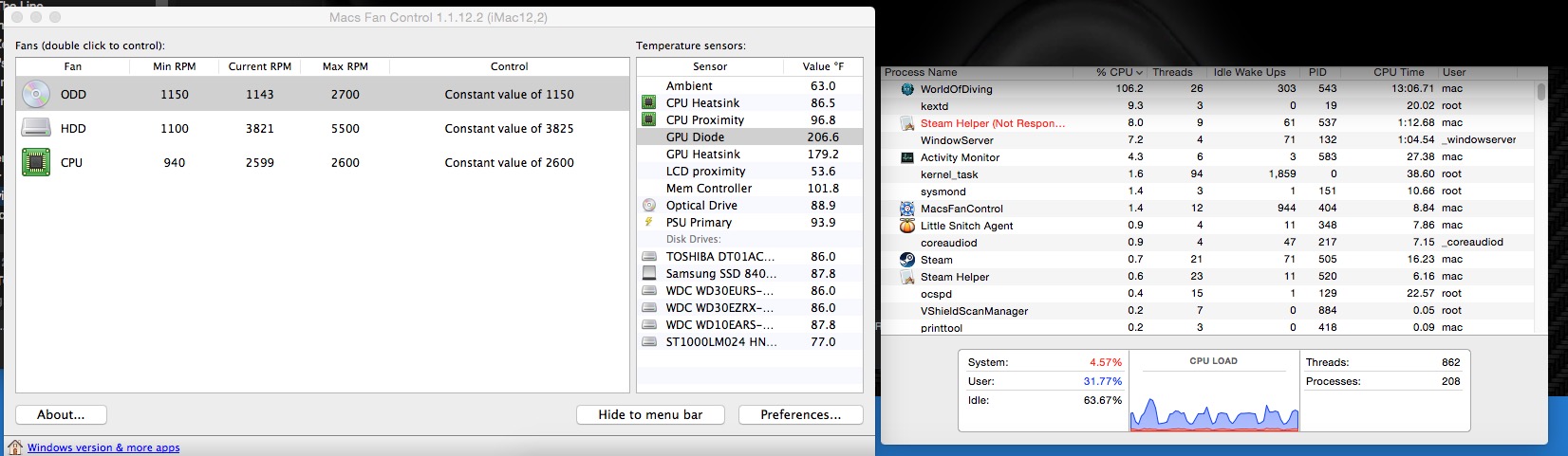

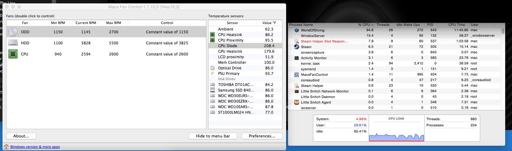

I did a cold boot - ran the 3D game and it ran fine for 5-6 minutes. I recorded the data at the start and after the problem started. See what you think of temps. Also if you download and run Mac Fan control (google it free app) you don't need to adjust them, it will read your temps even if you don't configure your fans to change from normal.
Anything look out of line for temps?
BEFORE problem.
After the problem.

Your temperatures don't look super bad in those images, although it all depends on what the GPU's operating temperatures are rated at (this is usually in their specifications). But like I say, over time running at a relatively high temperature will take its toll regardless of moment-to-moment temperature.
