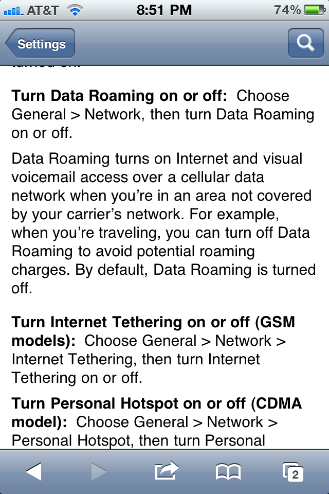

I could be mistaken, but that statement leads me to believe that you don't understand what the data roaming feature is.
Turning data roaming off is intended to keep from you using data on networks (overseas) where you would have to pay big bucks. I'm speculating that through some interaction between the iPhone and the Verizon network, the iPhone believes it is on such a network and turns data off (if you have the Data Roaming switch set to off).
Since it thinks your overseas it doesn't bother to check again until you either power cycle the phone, or cycle it through airplane mode (the recommendation of the genius I spoke to). Setting Data Roaming to on obviates the issue because it will always try to connect to a network.
What do you understand Data Roaming to be for?
It is for roaming between carriers, it doesn't make any difference whether you are overseas or not. The phone knows that you are not out of the country as soon as it connects to a tower. That said, your speculation does seem plausible though. But, if that was the case, I would certainly think that Verizon would be pointing the finger at Apple, and I haven't heard or read that anywhere.
