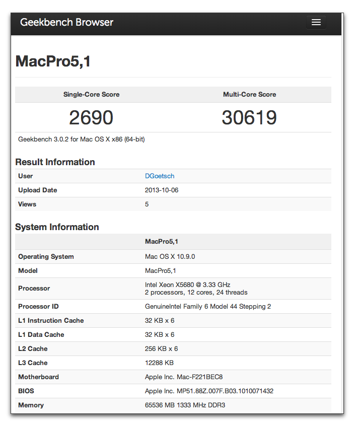

I'm running dual 680's and for sure my boot time increased. It also increased when I added more ram. But once boot is complete and I'm up and running the performance is insane. Your GPU should have no bearing on your Geekbench score. When diagnosing these performance issues it's best to strip your machine to the basics. If you have a spare drive put a clean install of OS X on it and boot from it. Strip the ram to one stick, pull all unnecessary pci-e cards, unplug all peripherals. Then do some testing/benching while re-installing the items one at a time.
Running dual flashed 680's on Mavericks this is my current Geekbench...
I know the GPU is not involved in the Geekbench, that's why i can't understand what it could be. I'm gonna take the mac back to the basic configuration to see the changing of the benchs when adding everything i added
