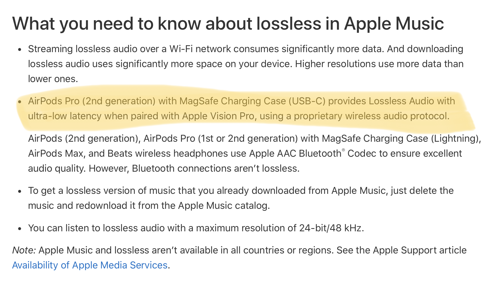

Has anyone seen anything online about how this works?
