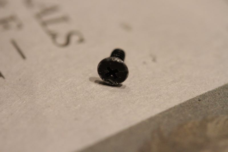

However, one of the existing #00 3.5 mm screws for the bottom case just barely held a thread, and this time after 8 years when I put back the bottom case for the umpteenth time, that screw wasn't catching anymore. I think the socket lost the outermost thread. I tried the other same sized screws, and none of them would hold that one spot.
I tried just using it without the screw for the time being, but the case would occasionally "click" when I set the computer down, which was annoying. So after some searching through my computer screw collection, I found one screw with the same thread but just a touch (1 mm?) longer, allowing me to put the screw there. It held, but it didn't fit right, because head was too big for depressed area around the screw hole where the screw head was supposed to sit.
So, I got the idea to shave down the edges to make it fit. I took out some knife sharpening stones I happened to have and using just my fingers to hold the screw, I put some elbow grease into it to shave it down. I also scraped off the black coating to make it silver to match a little bit better.

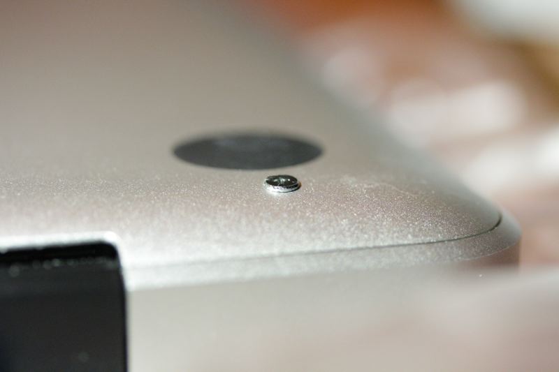

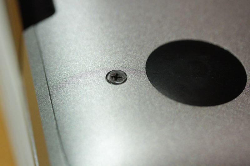

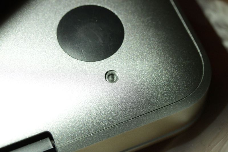

I managed to get it to fit, after about half an hour of this, including the searching time for the time I lost the screw on the floor. 😱 You can see that I didn't do it very evenly, so the screw isn't even round anymore. 😛 But it fits, so I'm happy.
Actually, the head is slightly thicker than the original screw, so the top of the screw isn't recessed like the other screws are, but close enough. The picture makes the screw look dark grey, but it's actually more like a silver grey. Not as light as the original screws, but unless you're looking for it, you probably wouldn't usually notice the difference.

There are 10 stock screws, including 3 very long ones, and 7 short ones, the latter of which I believe are 3.5 mm long. These 3.5 mm screws fit into that screw hole. However, I've tried several of the short screws and none work. Furthermore, it seems their threads are OK on visual inspection. So yeah, it's likely the thread in a screw hole that is the problem. I'm not keen on boring it out, since it would also mean boring out the hole in the case too, but then the recessed area would even more be too small, running into the same problem I illustrated in the pix above.
For that one screw hole, I wonder if the distance to the outermost surface of screw hole from the case may be slightly longer, meaning the screw doesn't thread in very much. The shape (and angle) of the hole bracket is very different from all the other ones, so it's not surprise that is the one that had the problem. Fortunately, the depth of the hole is much longer, meaning much longer screws can be used there. The thread deeper down is still intact, which is why simply using a longer screw worked. The screw I modified to use is 1 mm longer than the original screw.
