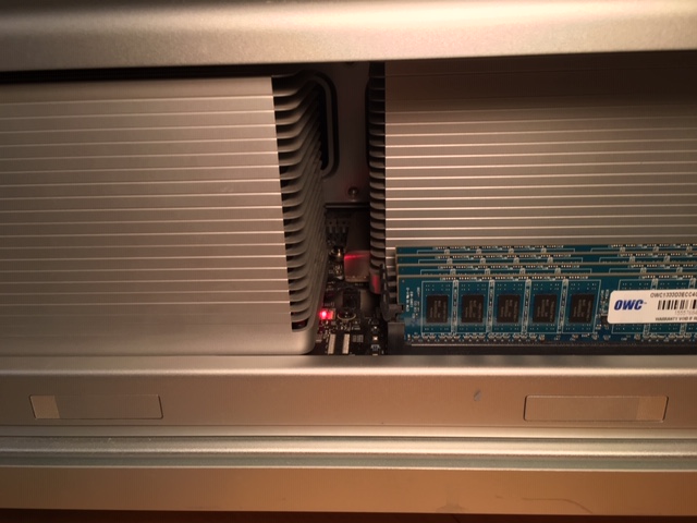

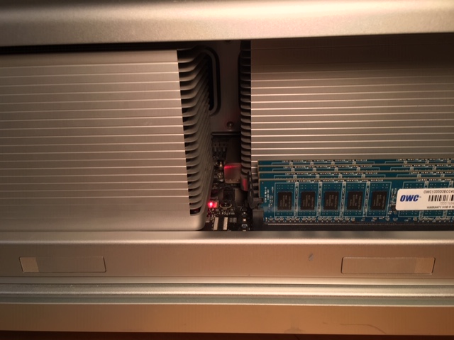

I also have this red light which stays on, not sure if it means anything.
Any suggestions?View attachment 814008
If you swap processors and the DIMM slot 6 continues to fail, red light is the fail indicator, you have a problem with your CPU tray, probably a finger on the CPU socket is bent/dirty/etc.

This is the type of thing that is better to find what is causing, you don’t want a computer that has RAM/socket problems.
One thing that you can do is swap the processors, from A to B, if the RAM slot that is not recognized changes, it’s the processor.

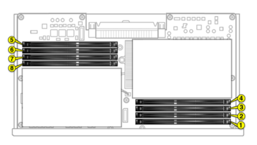

Download the Service Manual for 2009 Mac Pro, you will find everything to diagnose your Mac Pro.
CPU A - DIMM slots 1 to 4
CPU B - DIMM slots 5 to 8
