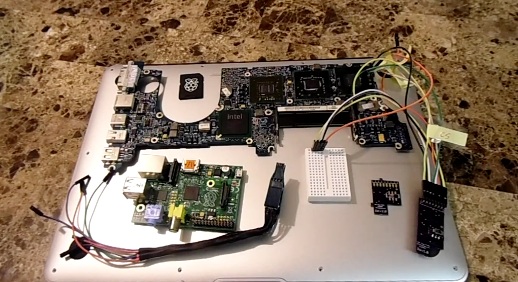

It's possible to obtain the EFI password from the EFI dump.
It's also possible to flash the EFI with one from another MacBook and bypass the EFI lock.
That said, this is probably not something most people can do.

As tubeexperience pointed out it is possible to hack, not likely but possible. Without a basic understanding of micro chip controllers and linux it is however a moot point. An unlikely skill set of most would be thieves. This is also why I recommend everybody to encrypt their drives in addition to firmware locking their Macs to protect their data.
[doublepost=1462612295][/doublepost]Flashing the EFI starts out like this. This is far beyond the scope of what people can realistically expect their Macs to be subject to. Nevertheless a valid point made by tubeexperience. My original post should be amended to highly improbable not impossible to use.
Image courtesy of THAGH05T.

A firmware password is in fact enabled at boot. Without this password a Mac cannot be booted into recovery, have the OS reinstalled, enter target disk mode, boot from an external drive, resetting the PRAM, etc etc. It does exactly what you are asking. It is not easily broken into, in fact it takes quite a bit to bypass this. See the photo above I attached for an idea of just how far beyond the scope of most people's skill set it is to bypass the firmware password.
