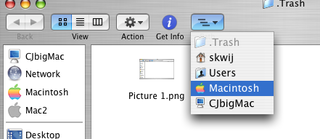

To access the trash, spotlight Trash.
The .trash (notice the "dot") should be your trash folder.
Yep, that's it. I just dropped the screenie I just took, into the folder, then respotlighted it. The pic is in the trash, so this is a viable way to find your trash folder without having access to a dock.
Alternatively, open a Finder window, and choose Go (menu) > Go to Folder… (shift+cmd+g) and type (or copy-and-paste) in ‘~/.Trash’ without the quotation marks. You’ll then see your Trash folder.

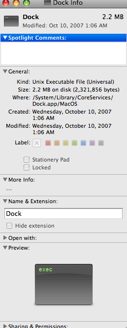

ok, thanks for the help everyone. i was able to access my trash and i saw that i also deleted another folder by accident.....the name of the folder in the trash was "MacOS" and inside there was a "Dock" icon that when i clicked it the dock came back the same way it was before i screwed everything up.
the problem now is, it opens another terminal window when i click on the dock icon, and when i close terminal the dock disappears with it. does anyone know a way i can run this "dock" application without using terminal.
i attached two screen shots of the dock icon and its info.
thanks again.....im staying away from terminal from now on.
OK, first of all the MacOS folder with the Dock.app inside was deleted from the "package" contents of "Dock" within Core Services..... now for some details to fix that by putting it back in the right place:
You need to first off get the MacOS folder out of the trash for simplicity- get it onto your desktop.
Now:
• Open a window to your hard drive
• Open the System folder
• Open the Library folder
• Open the Core Services folder
• Hold Control and click on Dock
• Pick "Show Package Contents" from the list that appears
• Open the Contents folder in the new window that will appear
• Drag the MacOS folder (with the dock.app inside) into the Contents folder window that is open. You may need to authenticate with your password to move the folder into place.
• Close all the windows
• Do one final "killall Dock" in Terminal
• Dock should then act normally
After this, perhaps consider using some of the prepackaged dock changing solutions- I would suggest SuperDocker or CandyBar.😉
