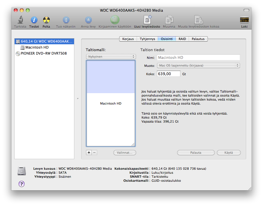

What can you see in Disk Utility? Click you HD (NOT Mac HD) and the partition tab. Can you include a similar screenshot as mine?

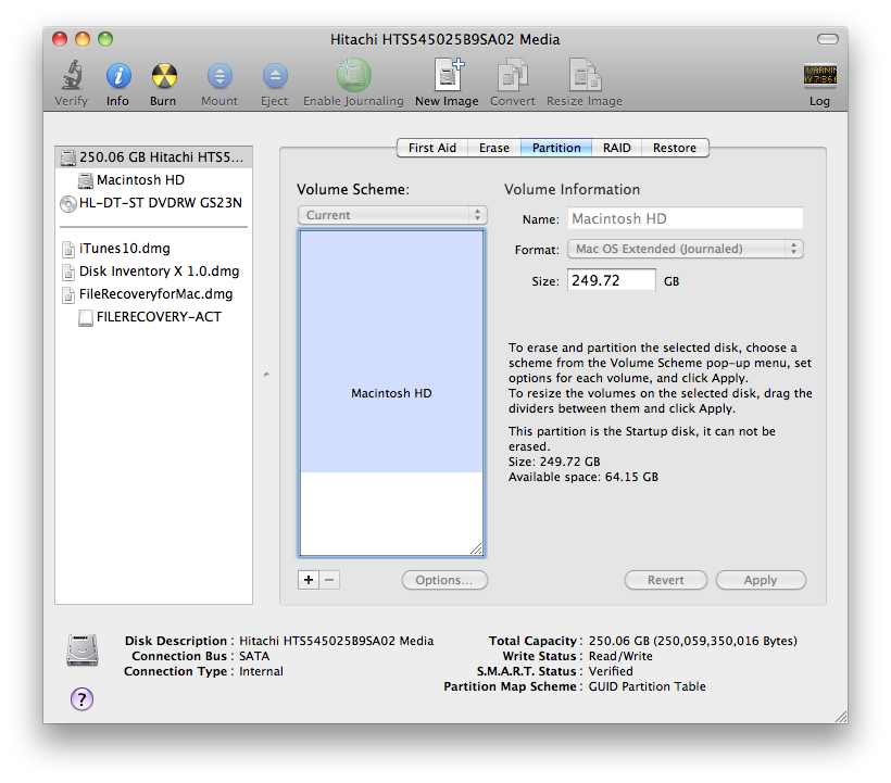

I trieed looking at disk inventory X but it only shows 98.6 GB of what finder says is 174.6GB of used space.
how would disk utility help? is there a solution to this?
At this point I'd run Disk Utility from your OS X install disc and try to verify and repair the filesystem. Looks like space is allocated, but not tied to a particular file since otherwise Disk Inventory X should have seen it.
