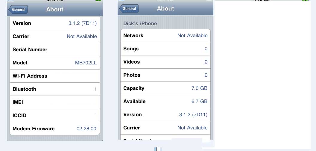

Can you take a screenshot please.
Settings > General > About
Make sure it shows the Version and Modem Firmware fields in the same screenshot
