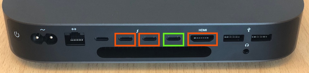

I seem to have lost my thunderbolt port near the HDMI port on my Mini with beta 6. Anyone else have this issue?
Yes, I had the same problem: I use that port for one monitor (it is connected to a USB-c HDMI adapter) so after the first reboot I lost the second monitor.
Now it is working again, not really sure which of the following actions solved the issue:
1) at the beginning I simply changed the USB-c port to verify if the problem was the monitor
2) I also tried to reset Pram (I still did not understand if that action still works in Macmini 2018
3) I unplugged the power cable for about 30 seconds
When I restarted the mini, after a while, the second monitor appeared again (obviously I re-connect ed it using the port nearest to the HDMI).
Bye,
Mr Hyde
Indeed . . .
Suddenly my 3rd monitor stopped working, and all the ports on the USB-VGA converter went 'wonk' . . . thought it was the converter. Anyway, after a lot of pissing about it turns out that the port marked in green on the back of the Mac Mini seems to be 'dead', and I am able to get the 3 video signals out of the ports marked in orange (which the official Apple documentation says is not possible) . . .

Probably worth resetting the SMC as it sounds like @mr_hyde did:

Interestingly enough, that same USB-C port "broke" on my Mini when I upgraded to 10.14.6.
I immediately upgraded to Catalina and the port works again. So my hunch is it's updated firmware that breaks the port.

I had the same issue installing Security Update 2020-002 on Mojave 10.14.6, with one of my two displays not working.
I have previously had the motherboard fail on this mac mini, so assumed it might be an overheating issue - luckily pulling the power out for 30 seconds to reset the SMC resolved it. You would think Apple might mention the issue !
The first Thunderbolt port closes to the HDMI port has a special role for communicating with the T2 chip / BridgeOS.
I presume the security update probably includes some firmware update for T2.
When my motherboard previously failed and would not boot, the Apple store still could recovery my data from the SSD using a program only available to them unfortunately, which connects two macs together using that Thunderbolt port. You can also put the machine in DFU mode using the Apple Configurator tool and that port, so it has a special function.
This support article is also useful, which shows how the four ports are organised in two buses
https://support.apple.com/en-us/HT209224 Connect multiple displays to your Mac mini (2018)
