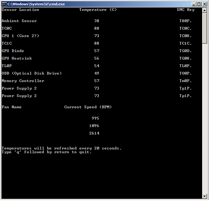

For the past couple months or so, (maybe starting around January) the fans on my iMac have been really loud for some reason. It's mainly the fan that's in the bottom left corner, if I put my ear up to it it's really loud, sounds like sitting inside an airplane while it's taking off. I use Bootcamp with Windows 7 Ultimate x64. It happens every time my CPU usage goes over 15%. So basically every time I play a game, even if it's not that intensive especially considering the decent hardware inside this system (i7, 5750) the CPU fan goes up to 4000 RPM, even when I just leave it for a while on the pause screen! I've installed Speedfan to check the temperatures:
HD0: 58C
Core 0: 55C
GPU: 212751C (it must be broken or something)
Core 1: 53C
Core 2: 56C
Core 3: 52C
Using iStat Nano to read the fan speeds, I'm getting approximately:
Fan #0: ~1000 rpm
Fan #1: ~1500 rpm
Fan #2: ~3500 rpm
I can control fan 0 and fan 1 speeds but NOT fan 2 speeds. I've tried SMC reset and all that. This problem is pretty surprising for me since my iMac fans have been fine for almost 1.5 years (mid-2010 edition) and now the Fan #2 at the bottom left (at least that's what I think is making the noise) is really loud! (EDIT: I confirmed it's the CPU fan using iStat nano on the OS X side since it gives you the name of the fan)

OK I did another SMC reset. Right now I am using about 10-20% CPU usage and ~2 GB of memory in Mac OS X since I decided not to use Bootcamp (I have two youtube videos open, one playing and one not playing). The temps are (using istat nano so GPU temps arent messed up):
HD: 58
CPU: 63
Ambient: 38
GPU Diode: 60
GPU Heatsink: 61
Mem Controller: 55
Optical Drive: 51
Power supply 2: 75
Fans:
Optical Drive: 1206 rpm
Hard Drive: 2136 rpm
CPU Fan: 3164 rpm
Fans are already noticeably loud, ~15 minutes after SMC reset and reboot. And the temperatures aren't that high yet. What's going on??? 😕
EDIT: 5 minutes later and it's at 3650 rpm...All I did was open up another YouTube video.

Let me rephrase the problem...when I play games and other cpu-intensive stuff, the CPU fan goes absolutely insane, around 4000 RPM which I believe is around the max it will go. It sounds like a jet plane taking off. Now I know from past experience (i.e. before this problem surfaced) and from other iMac owners that the fans shouldn't be up that much. Even when I'm at the pause screen in Mass Effect 2 and my CPU usage is only about 20% the fans speed up to 4000 rpm. It's extremely loud and annoying.
I ran the Apple Hardware Test and got this. Any thoughts?
4MOT/4/40000003:HDD-1344
Since it looks like a problem with the HDD, could it explain the high hard drive temperatures I talked about earlier?
EDIT: I also booted back to OS X to take a screenshot. This is after some normal computer usage (copying files, youtube, etc.) then light usage, i.e. did some moderate stuff 30 minutes ago like copying some GB's of files, then pretty light web surfing. As you can see hard drive temp is kinda worrying me. And the fans are noticeable but not loud yet.

OK, apparently there was a post-it note for no reason stuck on the corner of the hot air vent at the back of the top of the iMac. I took it out and I'm not getting 4000+ RPM CPU fan speeds anymore, which is very relieving. I'm only getting up to 3000-4000 RPM CPU speeds occasionally when gaming, and when I stop gaming the fan speed gradually goes down to 1500 RPM.
However, I reran the Apple Hardware Test and I'm still getting the 4MOT error I described earlier. The 4 digit number at the end fluctuates in the 1300 zone though. HDD temperature is still pretty high, around 57-59 most of the time. This may or may not "slow roast" my HDD over time so I'm concerned.
Should I go to the Apple store and ask someone about it? My warranty expired so I can't make technical support phone calls to Apple. I don't think I'm going to lug along my 27" iMac; I'm just going to see if the error message/temperature is a significant threat to my system.
EDIT: I went to the Apple store earlier today to get my iMac checked out finally. The HDD fan was broken, as I had partly suspected. The repair charges were $17.01 for replacing the HDD fan and $39.99 for labor. Not too bad. I'll be getting my iMac back around Thursday. I'll update again then.
(SORRY FOR TRIPLE POST)
I got my iMac back yesterday, and the hard drive is at reasonable temperatures now, so the fan must have been broken. The temperature goes up to about 55 degrees max, and usually hovers around 50. However, the CPU fan is still very noisy after intense gaming sequences. It was around 3700 rpm just after finishing a mission in mass effect 2. Although it spins down gradually for about 30 minutes down to ~2000 rpm which is pretty quiet. Here are my temps just after gaming, taken from MacFan's temperature reading program, which does not have the GPU temperature glitch that SpeedFan does. However I don't understand what TC0C, TC1C, or TL0P means, can anyone explain? And is the temperature+high CPU fan speed combination normal?
(the 2700 rpm in the picture should be about 3700 rpm or so)
