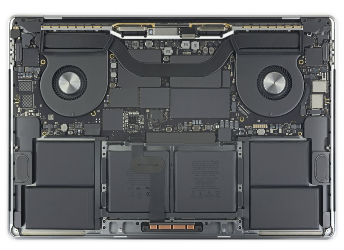

You are making wrong assumptions. Please, look at the picture.
There's only one heat pipe. In the center of it, you can see side by side the CPU on left and GPU on right.
The 5500m GPU runs hot. Very hot. And the same fans controls CPU temperature that blows air through the same heat pipe that goes in GPU.
So, please, understand that GPU heat is causing this fans to spin. Not CPU load.
When hooking in an external display all the work load is related to GPU. So, it's clear that it will heat up, leaving the heat pipe hotter and kicking the fans, even if CPU load is low...View attachment 881473

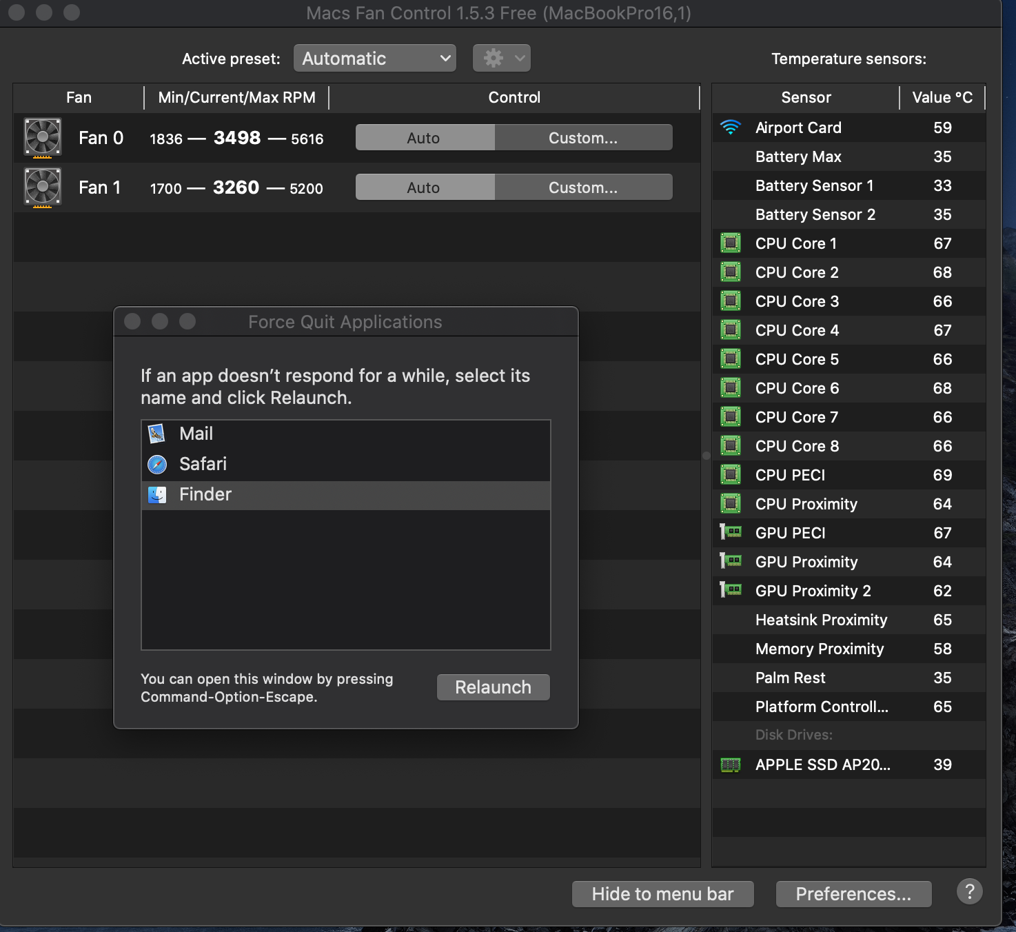

Then I see some other sensors are going higher slowly, once Platform Controller and ThunderBolt right sensors (where I connect my external monitor) reach 60 C, fans start spinning faster around 2600-3000 rpm.

Is it normal?? who knows but its danm annoying ! Here is a picture of my fan speed doing only safari and mail but yes connected to an external monitor.

The 5500m GPU runs hot. Very hot. [...] So, please, understand that GPU heat is causing this fans to spin. Not CPU load.
