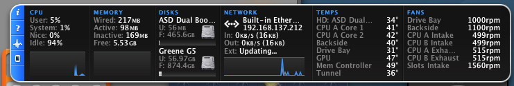

I checked out iStat, and the problem seems to be that my backside, expansion slot, and drive bay fans are stuck at a constant rpm and creating the noise. Tried the ASD and Thermal Calibration tools - no failures, no issues, but these fans still loud / stuck at the same values.
My question: Is this related to the 7800GT? It doesn't seem like it's running hot, but then again I'm not sure what a baseline would be here. Maybe somebody who has more experience with high end graphics cards of this era can help me out.

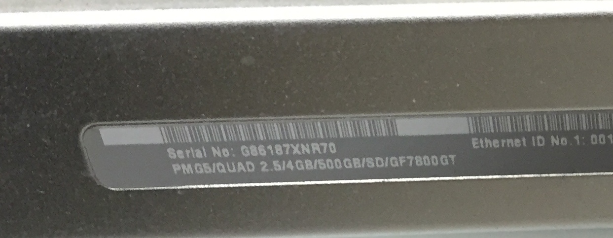

1. First, this isn't 100% reliable, but check the gray sticker at the bottom of where the door attaches to the case. If it shipped with a 7800GT, it will be listed there. Of course, the card could always have been added later, but if it shipped with one then it's probably an Apple card.

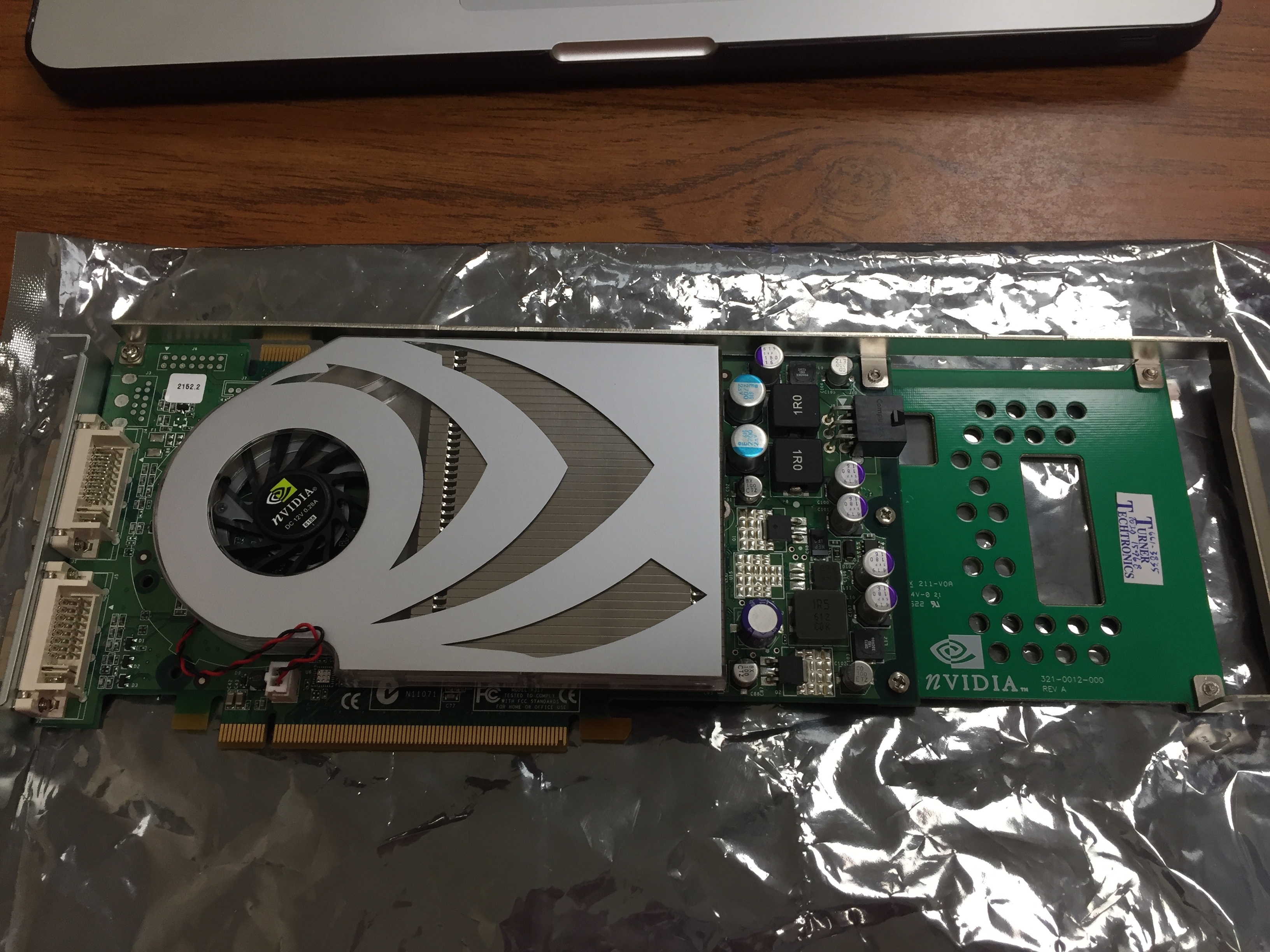

2. The OEM Apple card is a full-length card card with an extra added section of PC board and metal bracing to engage the anchor slots in the G5.
The card is an Apple OEM card then, it has the same extra section of PCB. Funnily enough, the label says this mac shipped with a 6800. I have the OEM documentation for the card and the seller was a company that used this computer as a graphics station in the mid 2000s, so I could see some graphics cards getting swapped around.
