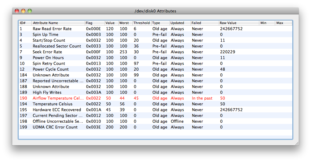

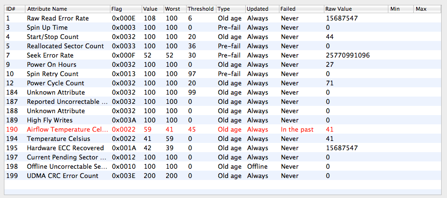

Here is mine about a week ago.
As you can see, the "raw" value for "Raw read error rate" is 15687547. Seek error rate is "25770991096" and Hardware ECC recovered is the exact same value as raw read error rate.
Airflow temperature has a raw value of 41 and a value of 59. In red.
Yet when I test this in disk utility it shows SMART as OK. I also tested with seatools and it also said everything is fine.
Is this within spec? These kinds of errors? Keep in mind that at the time the screenshot was taken there were only 27 power on hours (as detailed in the SMART report).
Now, I've heard that this is normal for seagate drives:
http://www.tomshardware.co.uk/forum/page-224921_14_0.html
They basically say that raw values can contain whatever, and you should only look at the value and worst column compared to threshold. If it goes under threshold, then you're in trouble. I don't know if this is true.

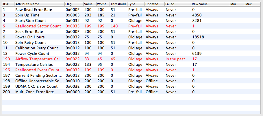

To compare, let's check my old imac G5.
Now, it seems to have some problems of it's own, but lets ignore those.
This one has 18518 power on hours. 0 raw read error rate. 0 seek error rate. Airflow temperature raw value is 17, value is 89. Red.

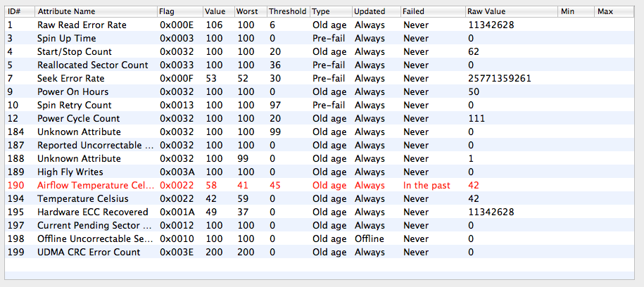

I have done a couple of hardware tests and today I did another smart test on my new imac.
This is the updated figure:
This is one minute later:
Keep in mind I'm not doing much of anything. Just writing this message. The errors seem to be increasing very fast.

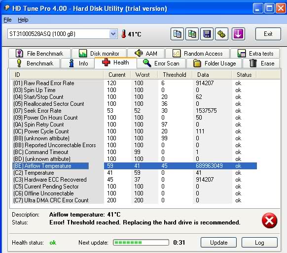

So, if someone could please add their smart output as well, that would be very much appreciated.

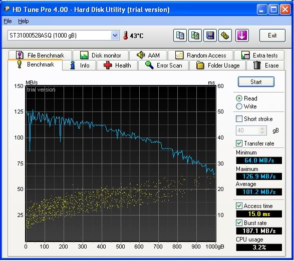

I also did a couple of hardware tests with hdtune pro for windows. You can see some graphs here:
The reading seems to have a downward trend and sometimes sudden spikes lower. Is this normal? Average read is only 98MB/s.

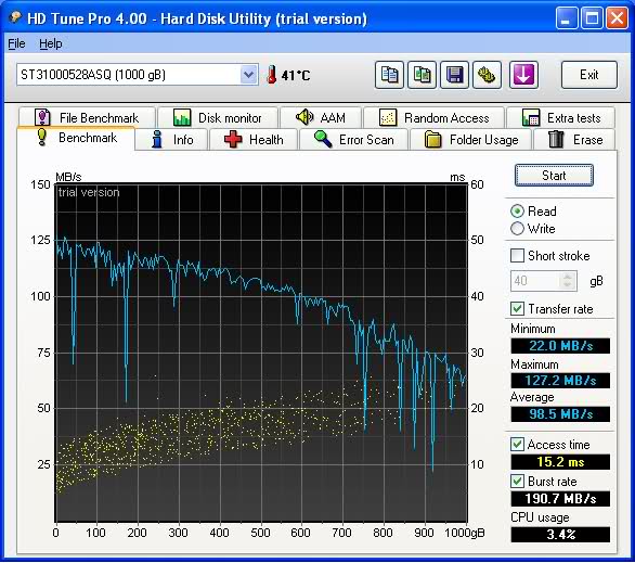

I did the test once more to confirm:
Here i also tested the smart:
I admit, I don't know much about these smart tests, what does the "value", "worst", and "treshold" column signify? What is the difference between value & raw value?
Any help would be much appreciated.

ok here it is
And its kinda noisy. but not all the time. more when im downloading. and sometimes when im browsing the web.
Hope this helps solve the problem ! keep it up.
cheers Michiel
Ok,so it seems those values are normal. Darn. Hoped there would be an anomaly but there doesn't appear to be one. Thanks for posting though.
Let me know if there's anything else you'd like me to look at. I'm definitely interested in helping the community out.
I'm fresh out of ideas. since these seagate drives don't have access to AAM or APM there's not much that can be done about the HD sound. The only thing to hope for is that apple updates the HD firmware to get rid of these issues.
Of course, if anyone else has any ideas, please do contribute!
